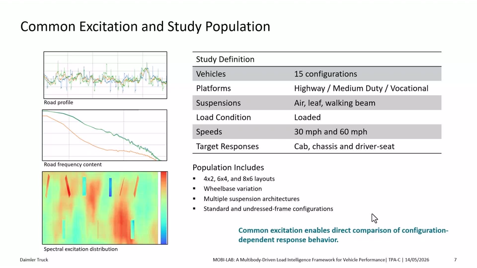

Modern durability workflows rely heavily on multibody simulation (MBS) to generate load time histories; however, the scale and variability of these datasets present a significant challenge for interpretation, reduction, and reuse. MOBI-LAB (Multibody Operational Behavior & Integration Lab) addresses this gap by establishing a structured, data-driven framework that transforms raw multibody simulation outputs into actionable load intelligence.
At its foundation, MOBI-LAB integrates multibody-generated load histories across multiple vehicle configurations, duty cycles, and operating conditions into a unified database. Rather than treating each simulation as an isolated result, the framework organizes loads by subsystem, channel, and configuration, enabling direct comparison across a fleet of vehicles. This multibody-centric approach preserves the physical fidelity of system-level dynamics while creating a consistent structure for downstream analysis.
Advanced signal processing and feature extraction techniques are applied to the MBS outputs, including time-domain statistics, frequency-domain representations, and fatigue-relevant metrics derived from load histories. These features are then used in dimensionality reduction and clustering workflows (e.g., PCA and k-means) to identify dominant load behaviors, group similar operating conditions, and quantify variability across the dataset.
The result is a scalable methodology for reducing thousands of multibody simulations into a manageable set of representative load cases. These cases can be propagated to finite element and fatigue analyses, enabling more efficient and statistically grounded durability assessments. Additionally, the framework supports the integration of machine learning models to predict load characteristics based on vehicle configuration, further enhancing early-stage design capability.
