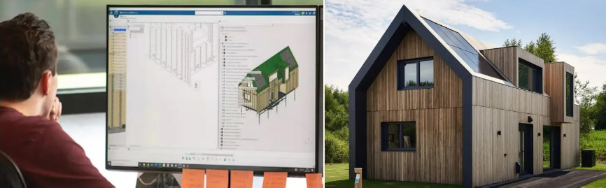

Leveraging unified modeling and simulation – known as MODSIM – on a single platform, design and analysis engineers took advantage of the platform with the critical advantage of creative, collaborative design with enhanced product insights. This approach also helps minimize risk and maximize performance, all while accelerating sustainable innovation.
Unbrick’s first project using the design capabilities of the 3DEXPERIENCE platform was to engineer a series of premium holiday homes.
“Traditional systems and workflows tend to be quite primitive – it’s not unusual for files to be shared via e-mail, or even for printed plans to be sent by post, which makes it difficult for stakeholders to know whether they are working with the most up to date design files,” Tonino said. “Using CATIA on 3DEXPERIENCE, we were able to produce incredibly detailed virtual twins of our homes. We could create high-resolution plans from these virtual twins that could easily be shared with external stakeholders who can actually log into our platform and work with us there. They can view the live data and get a complete bill of materials, so the process isn’t open to interpretation – which means there’s less chance of errors. Mistakes are very costly in this business, so that’s a huge selling point for us.”

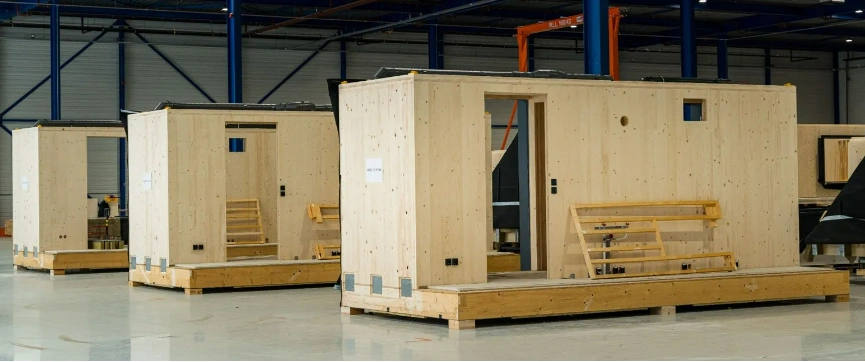

These external stakeholders include the FSC-certified wood supplier, who is able to access the designs it needs to pre-fabricate parts directly on the platform. The wood is cut using CNC machines, following very detailed plans that optimize how the roll stock should be cut to minimize waste. The various pre-cut components of the homes – like the floors, walls and ceilings – then arrive at Unbrick’s factory ready to be assembled.
“Following the step-by-step work instructions that we have created using DELMIA, our engineers then assemble the homes in the same way they would do with a LEGO® model,” Tonino said.
“You can even see the threads on a screw,” Smits added. “It means the assembly team can tell exactly how deep they need to screw. There’s no room for guesswork on anything. And, because the plans are so detailed and easy to follow, it also makes it easier for us to recruit and train production staff.”
Unbrick assembles the different rooms in their own purpose-built facility, before delivering them to site.

By doing everything from a single location, Unbrick has streamlined the way it works. The shell modules are developed in one production hall. Once complete, these modules are then moved into another production hall, where they are made up into rooms – this might be a kitchen, a bathroom, a living room or a bedroom, for example.
“Once we’ve finished one house, which takes two to three days, we can move straight onto the next,” Tonino said. “Not only is this a much more efficient way of working, but it also makes it easier to spot any problems.”
The completed modules are then transported to site for assembly – a process that takes just five hours.

Using SIMULIA’s parametric design functionality on 3DEXPERIENCE, for example, the engineering team is able to seamlessly evaluate a number of design variants and pick the design that best satisfies their requirements in attributes such as function, sustainability, costs and labor involved.
“It influences practically every decision we make,” Smits said. “But it also gives us the freedom to make as many iterations as we need to. We might try something, and if we see it doesn’t work, we can do an iteration. There are small differences from the first up to the fifth house we built. By the sixth, we had eliminated most of issues and mistakes. The iterative design functionality means we don’t have to keep repeating the mistakes.”
