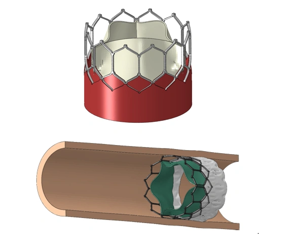

Figure 1: FEM Model of a Sapien-3 TAVI Device

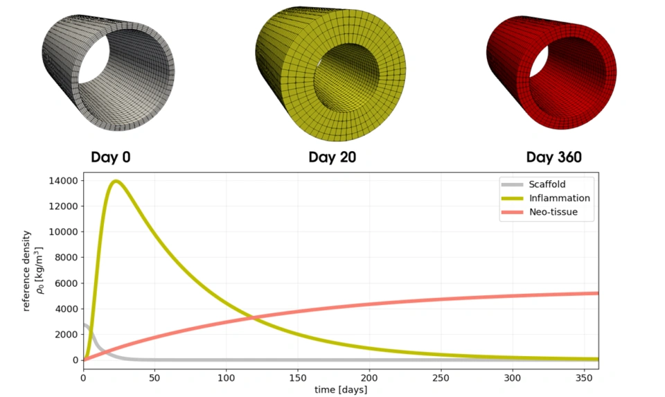

Figure 3: Conceptual Modelling approach to account for scaffold degradation and neo-tissue growth (KU-Leuven | EMSE)
Q: How are you using advanced computer modeling and simulation to help address the challenges of the biodegradable part?
A: Our main goal in this project is to develop two platforms. A platform is effectively a computer model that can be used to simulate how these devices could evolve within a given patient. We have two classes of devices for which we want to develop these platforms. And within these two platforms, we need to ensure that we have the right material models developed that can simulate the biological process of degradation and restoration. We are simulating a biological process. That material is changing: it is growing, and it’s changing its dimensions and its mechanical properties. Another group is the patient models, where we have a group that is collecting true patient data through a clinical center and using this data to generate patient-specific models from real patients who are undergoing classic TAVI treatments.

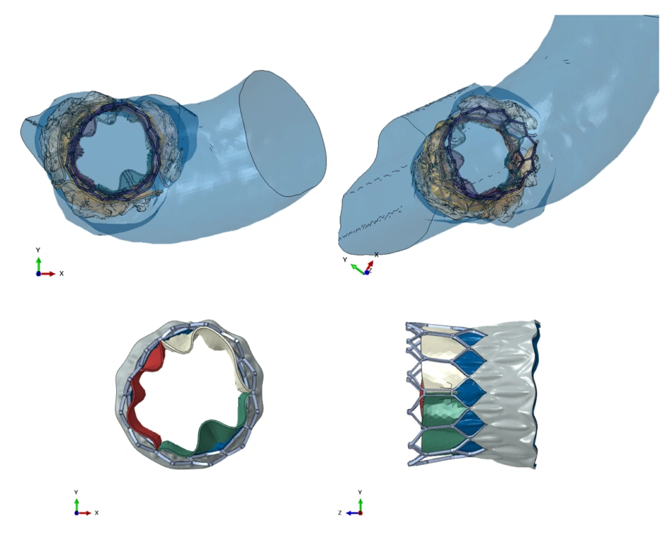

Figure 4: FEM Model of the TAVI device implanted into a Patient-Specific Model of the left ventricle and aortic arch (4RealSim | UniPa)
We can see how these classic devices are performing over time and we can use this data to build and validate our models. There are also different kinds of computational domains: material modeling, mechanical structural modeling, and blood flow. And because it’s a valve, the blood flow and the interaction with these valve components is the key element to simulate. Although it sounds simple, it’s a huge challenge. Fluid-structure interaction, or FSI, is one of the biggest building blocks but also one of the biggest challenges to put in these models because they are very computationally demanding.

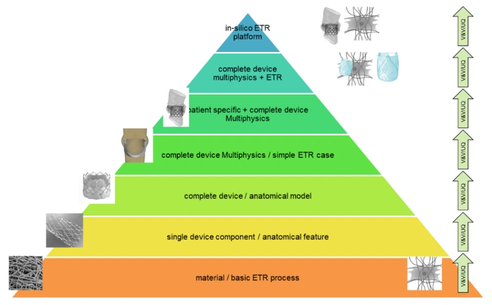

Figure 5: Hierarchical VVUQ concept to establish credibility in the SimInSitu Project
A key objective of the SimInSitu project besides developing advanced simulation tools for complex systems, is establishing the credibility of these models as well. This is generally done through VVUQ, which stands for Verification, Validation & Uncertainty Quantification, and which is a structured approach to make sure that the predictions done with the computer model are trustworthy. Our experience in the VVUQ domain increased tremendously, which we discussed and shared with other industries, like aerospace and automotive. We realized there is a lack of deep understanding and experience in using these methods as part of your daily job in a company or research institute. We at 4RealSim are trying to improve this situation by offering also dedicated training.
