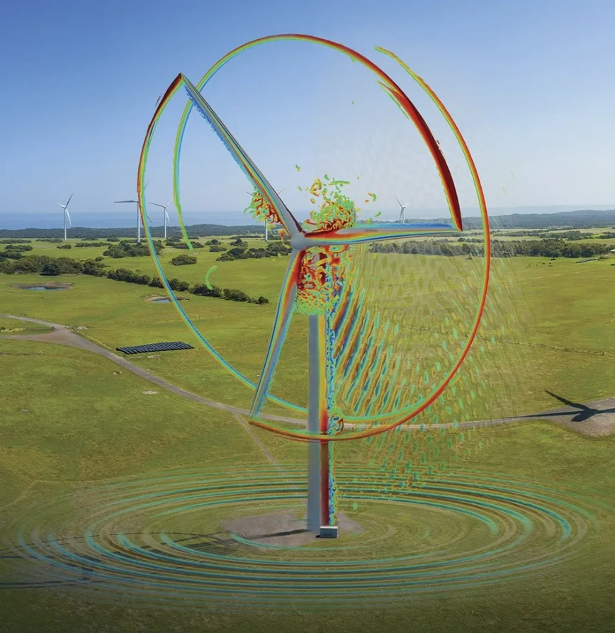

In response to these challenges, a collaborative effort between LM Wind Power and Dassault Systèmes has been underway to pioneer a simulation methodology to design optimal blade serrations specifically geared towards reducing trailing-edge noise in full-scale wind turbines. The crux of this initiative is developing a cost-effective simulation framework capable of accurately predicting noise emanating from two-dimensional blade sections when extrapolating to a full-scale wind turbine. This innovative approach bypasses the need for resource-intensive and expensive wind tunnel and field tests.
The methodology devised for this purpose leverages a combination of low- and high-fidelity simulations, harnessing the advanced capabilities of the SIMULIA PowerFLOW solver. This integrated approach enables the accurate prediction of noise levels over vast distances across complex terrains, covering kilometers of ground. The collaborative effort between LM Wind Power and Dassault Systèmes has culminated in a groundbreaking solution that not only addresses noise concerns but also circumvents the traditional challenges associated with wind turbine design.

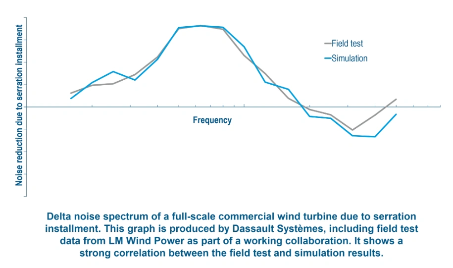

Crucially, the efficacy of this solution has undergone extensive validation through rigorous field tests. Guannan Wang, SIMULIA Champion and the lead acoustic engineer on this project, expressed the transformative nature of this achievement, stating, "This marks a new era for virtual prototyping and digital twin design, eventually leading to digital noise certification of wind turbines for us." This breakthrough signifies a pivotal shift towards a more sustainable and technologically advanced future in the realm of wind energy, where digital simulations play a central role in optimizing performance while minimizing environmental impact.

The introduction of a digital twin replicating the full-scale wind turbine provides a rapid and efficient avenue for executing design iterations and modifications. This virtual representation facilitates continuous testing within a comprehensive virtual wind tunnel environment, eliminating the need for oversimplifications. The simulation has been thoroughly validated through real-world field tests, demonstrating its remarkable accuracy. Utilizing SIMULIA PowerFLOW, the airflow and resulting noise emissions are meticulously studied, enabling the generation of an auralized noise signal on realistic terrain. This functionality proves invaluable in supporting design studies for noise-suppression add-ons.
