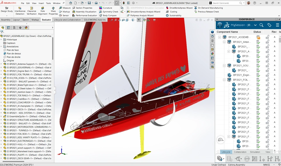

Mathieu Vincent joined the Initiatives-Cœur team three years ago, bringing a passion for sailing and expertise in engineering. As a design office engineer, Vincent creates critical components like rudders, keels and foils. His role also extends into simulations and analysis, making continuous design tweaks to push the boundaries of what’s possible with the vessel at sea.
“Two years ago, we upgraded the boat’s rudder systems by replacing the textile tie rods with rigid tie rods,” Vincent said. “I designed the new systems using SOLIDWORKS to analyze the kinematics and create the drawings needed to manufacture the components in our hangar. Having both the design and simulation tools in the same environment – the 3DEXPERIENCE platform on the cloud – saves significant time and allows me to do multiple iterations quickly. It’s easier to control the tolerances and end up with a final part that closely meets the initial specifications.”

In another instance, Vincent and the team used Dassault Systèmes’ combined 3D modeling and simulation capabilities (known as MODSIM) to design new jockey poles that could withstand the extreme conditions of offshore racing.
“Jockey poles are used to spread the clew [the lower rear corner] of large headsails when sailing downwind,” Vincent explained. “These poles have a base with a fork and chainplate that must endure heavy loads. Using SOLIDWORKS and SIMULIA, I designed and validated the kinematics, simulating different load cases with varied angles to make sure it would be reliable at sea. The parts have performed flawlessly.”
