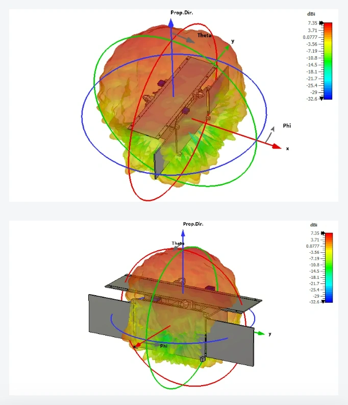

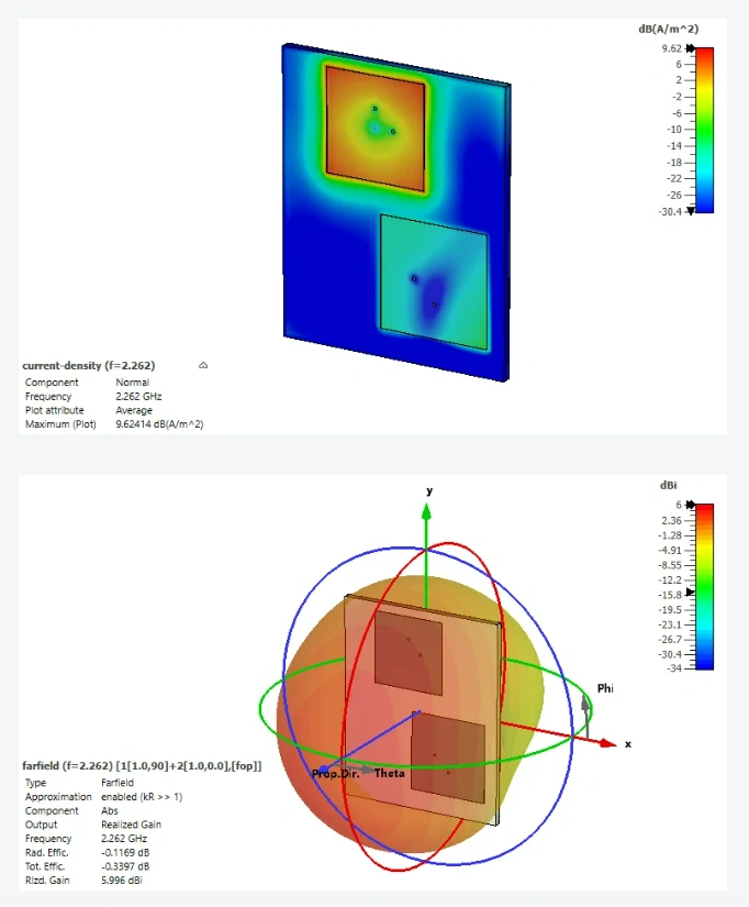

An RF system successfully transmits and receives radio waves for communication, sensing, imaging, and more. D Orbit uses Dassault Systèmes SIMULIA CST Studio Suite to conduct its electromagnetic simulation studies to design the complex RF systems in their innovative spacecraft. “CST Studio Suite enables us to create custom workflows dedicated to antenna placement to ensure that any radiating source does not interfere with the co-located receiver so that we can connect to Earth without any impacts or shadow zones,” reports Giannini.
Coordinating antennas to communicate without interfering with each other involves several strategies and techniques aimed at efficient spectrum usage and minimizing crosstalk between channels. A surprising number of factors can contribute to mitigate radio-frequency interference, including polarization diversity, dynamic spectrum allocation, time or frequency division multiplexing, reduction of out-of-band and spurious emissions, notch filtering methods, and more. These strategies can be used individually or in combination, depending on the specific requirements of the communication system, to coordinate antennas and mitigate interference effectively. The sheer complexity of it all is one reason electromagnetic testing is so important. CST Studio Suite dramatically reduces the complexity of these tests and can even rule out the need for other tests.
“If you have a scale from 1 to 10 in terms of complexity of tests, any test without CST would be a 10,” explains Giannini. “With CST, we can mitigate the problems and put margins on thresholds, which can be critical.” CST enables the D‑Orbit team to predict how the telecommunication link will work once the satellite is in orbit. “It’s our responsibility to integrate such antennas on our spacecraft. We must ensure that all antennas are properly assigned a spot on the spacecraft body to limit the crosstalk risk. We basically have no means to estimate how large the interfering effect will be between two antennas until we simulate such conditions using one of the electromagnetic solvers inside CST Studio Suite,” Giannini emphasizes.
