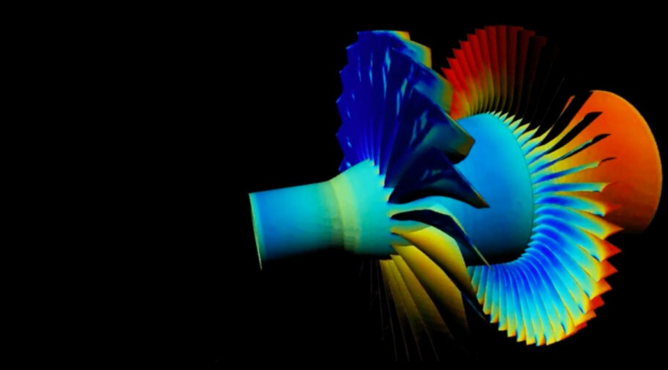

The noise is generated when the wake from the engine’s fan blades interacts with downstream stator vanes, redirecting airflow. This is known as “interaction noise” and it is the dominant noise source in commercial aircraft engines, especially during approach and landing. Its components include a tonal noise created by the mean flow difference in the wake behind each fan blade and broadband noise produced by turbulence in the wake. So far, this broadband noise has proven especially difficult to address. Solutions like resonators and duct shapes can be used to absorb specific tones, but they only work for narrow frequency bands (tonal noise). It’s much more difficult to absorb the large spectrum of sound that makes up broadband noise.
To model the fan noise problem, “you have to understand the fan wake, its interaction with and the shape of the vanes, how many vanes, how many rotors, how fast the fan is spinning,” Grace said. “There are many adjustments in these properties and in the duct that can be made to kill tones from the engine, but you can’t eliminate the turbulence in the fan wake and you cannot kill all of the noise it produces so there will always be broadband noise.”

Simulation can provide much more detailed insights into engine noise. SIMULIA PowerFLOW has emerged as an excellent tool for modeling the full fan stage using very large eddy simulations – a mathematical model for turbulence used in computational fluid dynamics. But while these simulations effectively capture turbulence and predict noise, they can be challenging to apply during the early design phase.
“PowerFLOW turbofan simulations have been used to explore various design questions, but they tend to be too intensive to use when assessing initial design,” Grace said. “Also, we’re dealing with different types of noise that are generated in various ways and if you’re modeling them with simulation software, you can get them all at once. But if you’re trying to just pull a little piece off and do a quick calculation, then you really have to drill down and ask, what exactly is causing that noise? And what could I pull out and model?”
