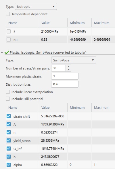

Note on the elastic-plastic model:  when fitting the full hardening curve, many papers on CDM (Continuum Damage Mechanics) prefer to use an equational form, rather than tabular form.  One particular equational form that is often quoted is the mixed Swift-Voce equation.  That form is implemented in the 3DX calibration app, though it is then output for use in the Abaqus solvers as a tabular set of points.  The original stipulation of the Swift-Voce equation used to calibrate the Deole test data is shown in the figure below.  The choice of 50 tabular points was later reduced to 25 points by a hand editing of the points in the .inp file.
