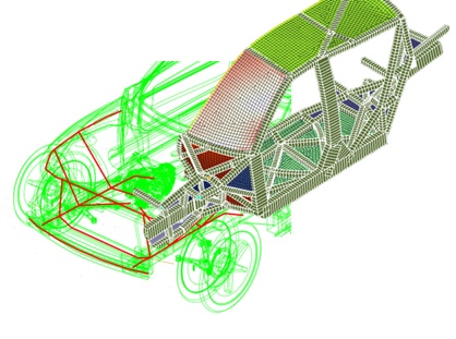

1D abstracted (STICK) model
The automotive industry faces dramatic changes with electric vehicles in terms of design, business paradigm, and shortening the product cycle. A flawless process from product planning to product manufacturing can reduce the cost and time of the production. Upfront simulation supports the idea by providing the simulation technique as early as the concept design phase to reduce or eliminate possible late design changes. The automotive structure needs simulation of the three performance attributes: crashworthiness, NVH (noise, vibration, and harshness), and durability.
There are hurdles in applying the FE simulations of the three attributes at the early concept design. FE models require complete geometry for meshing, but the concept design may not have the detailed geometry and the design may frequently change. The architecture design in the concept phase is the most effective solution for optimal crashworthiness performance. However, the crashworthiness simulation takes a significantly longer time than the other two. Hence, we need a workflow that provides flexible modeling and faster performance, which are essential to support the frequently changing concept designs.
OEMs have a database, accumulated over a long period of time, of structure design and crashworthiness results as well as the knowledge and experiences of design engineers. The concept design engineers may roughly predict the performance of the architecture in order to try to avoid possible problems. Factors in crashworthiness design include how to position the structure frame geometrically and how to decide the component section size that forms the best load path to observe and distribute the crash energy. Hence, the crash resistance and the section geometry database, and an abstracted model, are necessary for the concept phase.

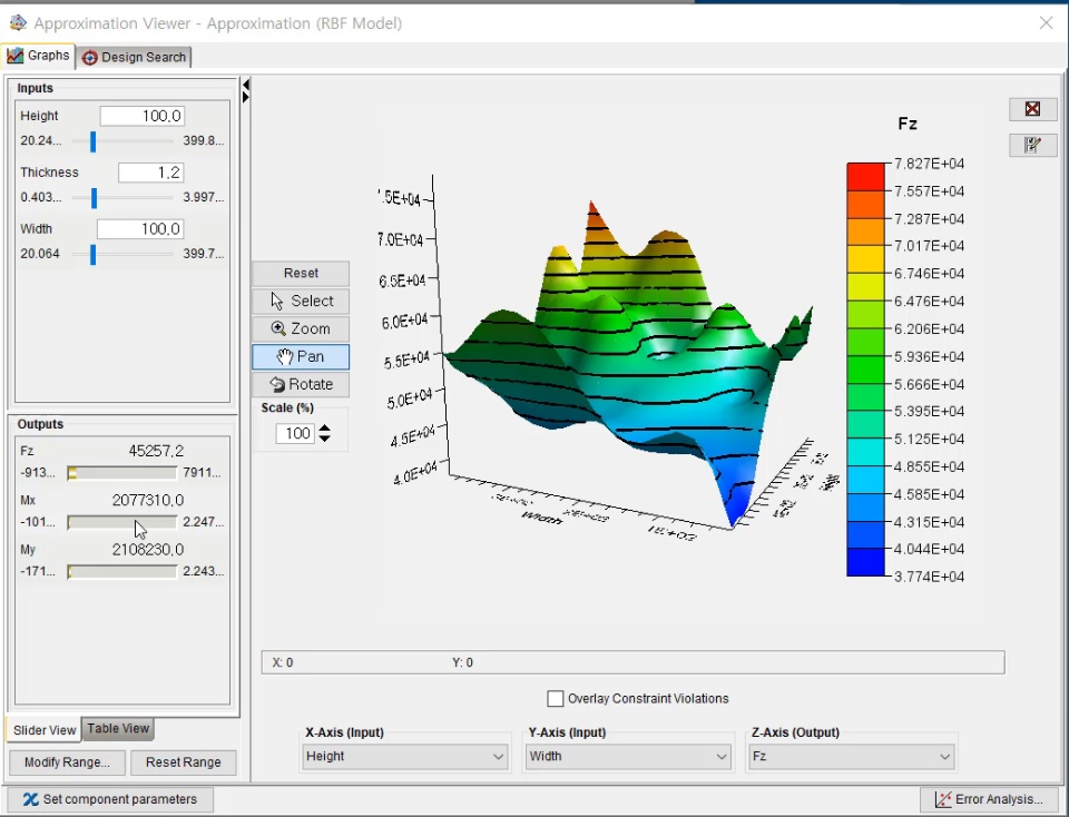

Metamodel – cross section geometry vs crash resistance
The database of crash resistance of the rectangular cross-section was generated for general use. In addition, an automated process of extracting the cross-section and the crash resistance from existing geometry data was developed for specific cases. However, the specific data is too small to create an approximation surface, but it is available to use as a lookup table. The abstracted model responses were matched with the references within the target range of 70% WIF, which proved the model was feasible to use for parametric optimization.

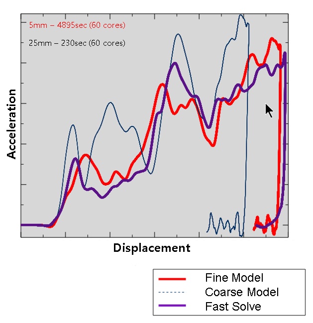

Coarse mesh surrogate – Performance gain using coarse mesh while keeping the accuracy within the acceptable range.
Then, we optimized the crash resistance of the model to make the response curves match with the targets using Isight. A few section geometries picked by the metamodel from the optimal crash resistance, and the corresponding FE model, were created by SFE Concept for final optimization and validation. In this phase, we used a coarse mesh surrogated model that runs as fast as 10-20 times the fine mesh model. This allows parametric MDO for crash in the loop with other performance attributes.
