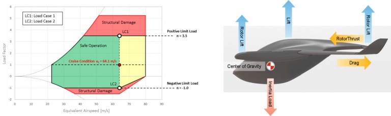

External loads in critical flight conditions must be balanced for structural sizing. In any given flight condition, the vehicle is subjected to aerodynamic loads, rotor forces, gravity, and inertia loads. Thanks to the 3DEXPERIENCE platform, using the Fluid Dynamics application, a Computational Fluid Dynamics (CFD) simulation model can be fully associated with the design. CFD simulation was set up to determine the aerodynamic loads of the conceptual eVTOL vehicle as a function of angle of attack, Mach number, etc. Rotor forces, balancing aerodynamics, inertia, and gravity loads were then computed to ensure flight loads equilibrium. This external load database was used to feed the structural model of the eVTOL. Two limit loads were considered: positive limit load and negative limit load as indicated by the black circles in the plot below.
Flight envelope diagram and different forces on aircraft

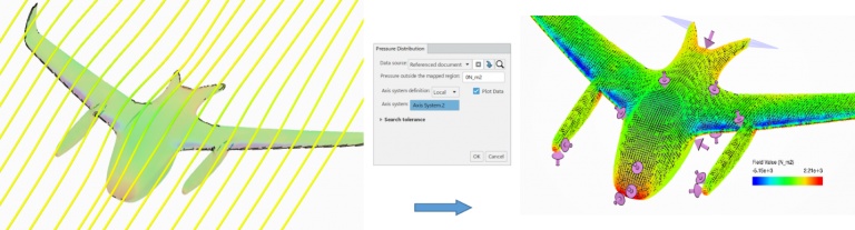

Fully associated with parametric design, a structural finite element model was built in Mechanical Scenario application on the 3DEXPERIENCE platform. Model meshed with shell and beam elements for different internal structures. The front and rear rotors, and battery, are idealized as point masses connected to the structure through distributed coupling constraints. It is assumed that the structure is made of standard carbon fiber reinforced polymer (CFRP) composite material. Along with inertia and rotor loads, the aerodynamic pressure distribution from the CFD mesh to the structural mesh was mapped for the structural sizing task.
CFD pressure mapping to structural model

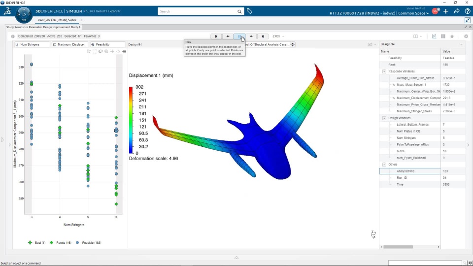

For parametric simulation models built in the 3DEXPERIENCE platform, the new Parametric Design Study application provides an intuitive and easy-to-use interface for setting up design of experiment (DOE) studies. A parametric design study was performed for the eVTOL vehicle considering various design responses such as stresses, displacements and mass.

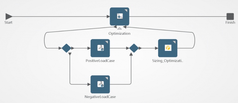

In this conceptual design study, parametric optimization and non-parametric sizing techniques were combined using the Process Composer application available on the 3DEXPERIENCE platform. A Pointer-2 optimization technique was applied directly to the parametric model.
Process Composer workflow combining parametric and non-parametric optimization

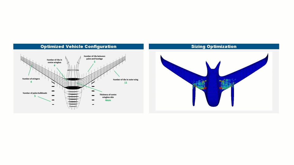

Under the optimization task both positive and negative load cases of structural model are executed in parallel for each iteration. The objective of the parametric optimization is to minimize the total structural mass subject to a stress constraint and a displacement constraint. Within each iteration of the optimization run, a non-parametric sizing task is performed in Tosca Structure to further reduce the mass by optimizing the distribution of outer skin thickness and stringer properties. The final optimized model was further checked for structural requirements like buckling and strength of the composite to validate the configuration.
