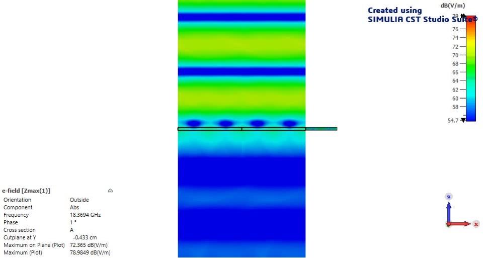

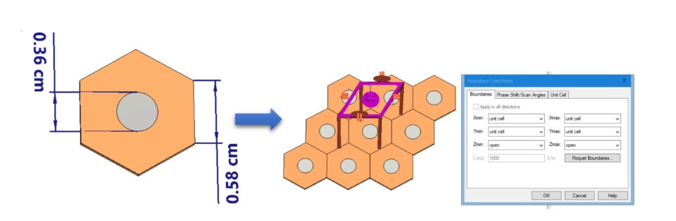

To start the FSS design, I consider a hexagonal lattice based unit cell of a dielectric filled by a metallic disk at center as depicted in Figure 1. It is simulated in CST Microwave Studio using the Frequency Domain Solver (F-solver) and Unit cell boundary condition (Floquet mode analysis).
Figure 1. Unit cell structure; Floquet mode analysis of infinite array with the help of Unit Cell Boundary condition provided inside Frequency domain Solver

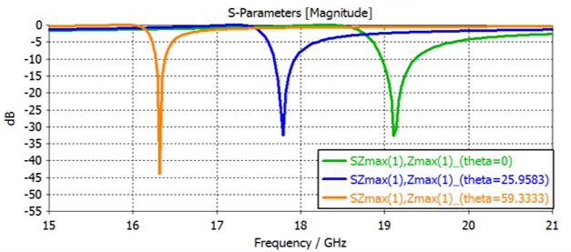

As the reflection coefficient of the unit cell suggests (Figure 2a), there is a frequency, namely at 19.12GHz, in which the fields can mainly penetrate through the periodic structure while there is a relatively huge reflection at other frequencies. Thus, it is safe to say that we have a kind of band pass filter.
The default setting of the unit cell boundary condition delivers the simulation results for normal incidence only. However, it is important to evaluate the electromagnetic behavior of the infinite structure at different incident angles. This can be easily achieved by performing a parameter sweep over the scan angle parameter provided in the unit cell boundary condition window. Figure 2a shows the reflection coefficient of the proposed unit cell under three different incidence angle of incoming plane wave. Figure 2b shows the electric field behavior at the pass band and notch band frequencies, accordingly.
2a)
2b) Figure 2. a) Reflection coefficient of the infinite array based on different angle of incidence, b) Electric field animation at transparent and opaque frequencies of the unit cell

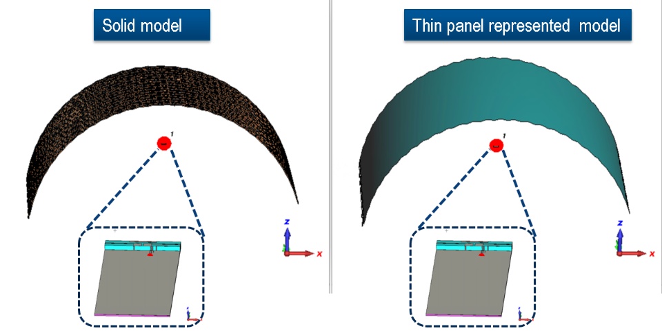

To show a proof of concept, I have simulated a half-cylindrically bended FSS based radome. An F-inverter antenna with omnidirectional pattern was used as the source antenna.
Figure 4. Curved FSS type radome and F-inverter antenna in full model (left) and thin panel represented (right) simulations.

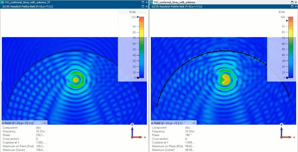

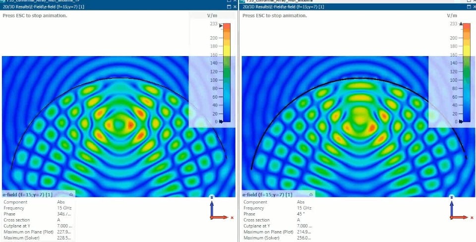

Notch-Band Frequencies:
For the notch-band frequencies (f=15 GHz, f=25 GHz), full model and thin panel approaches have been only investigated and plotted. The field animation of figures 5 and 6 show the almost perfect agreement between these two approaches for the structure under study.
Fig 5: Electric field visualization for solid model (left) and Thin Panel (right) at f=15 GHz.
Fig. 6: Electric field visualization for solid model (left) and Thin Panel (right) at f=25 GHz.

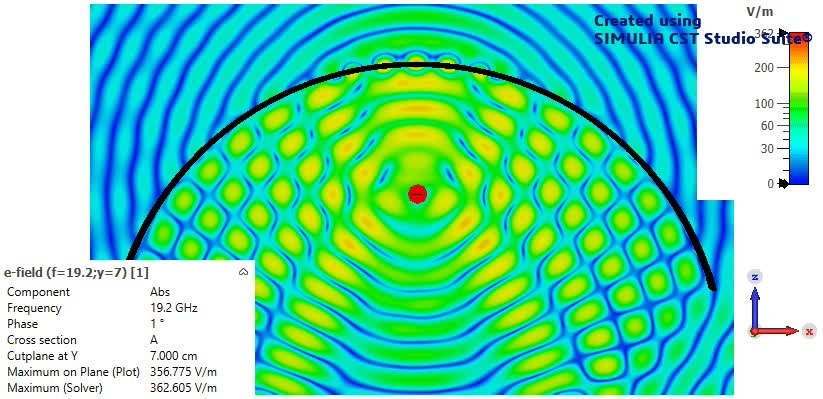

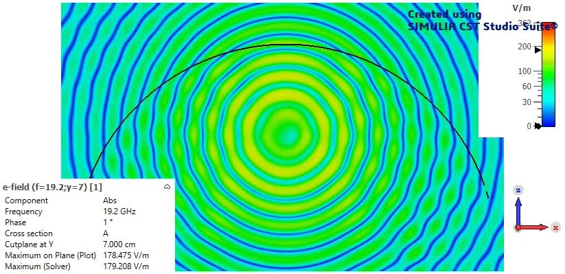

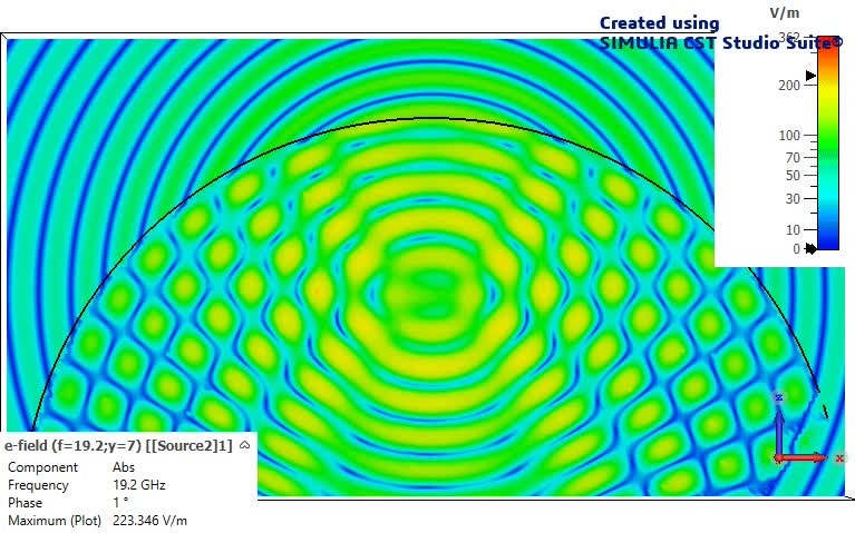

It is interesting to compare the simulation results for the pass band frequency – namely 19.2 GHz – as well. Since not all the radiated waves from the antenna hit the radome surface with a perpendicular angle, multiple reflections are generated simply because the reflection and transmission properties of the FSS unit cell changes with the incident angle (see figure 2a). This leads to standing wave behavior or cavity-like resonances. This effect can be seen very well in Figure. 7a. In addition, some surface resonances are generated that can be only captured using full wave approach as shown in the same Figure. The thin panel (S-matrix type) model, shown in Fig. 7b, is unable to deliver the same result compared to full model simulations. The reason lies on this fact that the thin panel material can only be defined based scattering matrix of one incident angle (we used normal incidence in this case) and therefore it does not include the reflection and transmission for non-normal incident angles.
Last, we used the Hybrid Solver approach to simulate the proposed model. A bi-directional coupled TLM and asymptotic solver is used to simulate antenna and radome models accordingly. Two solvers communicate through near field source and the relative residual error decreases below an acceptable threshold over a few iterations. It can be noted that the hybrid solver approach is also able to capture the standing-wave field behavior similar to the full model approach as shown in Fig. 7c.
a)
b)
c) Fig. 7: Electric field visualization at f= 19.2 GHz for a) complete model simulated in transient solver b) thin Panel S-matrix simulated in transient solver c) thin panel-Fresnel table simulated using hybrid solver of transient -asymptotic solvers

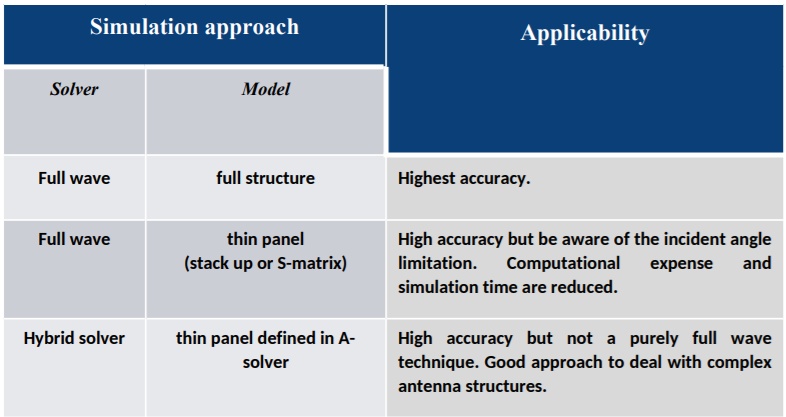

Conformal and frequency selective surfaces being used as radomes create a complicated electromagnetic environment that demand accurate and reliable simulations. In this study, three approaches were investigated starting from full-wave complete model simulation, full-wave and compact model simulation and hybrid solver simulations. Table. 1 summarizes the above-discussed approaches and their applications in FSS radome design. The author hopes that this short article could give CST Studio Suite users deeper insights to select the most suitable solver/approach for their antenna/radome simulations.
All the geometry creation, handling, simulations have been performed with CST Studio suite. Transmission line matrix (TLM) solver, asymptotic solver, frequency domain solver, and hybrid solver workflow were the solvers that have been used in this study [4].
CST Studio Suite offers different approaches to strike a good balance between accuracy and simulation times for different types of radomes.
Table 1: The summary of the user guideline for radome simulations in CST Studio Suite.
