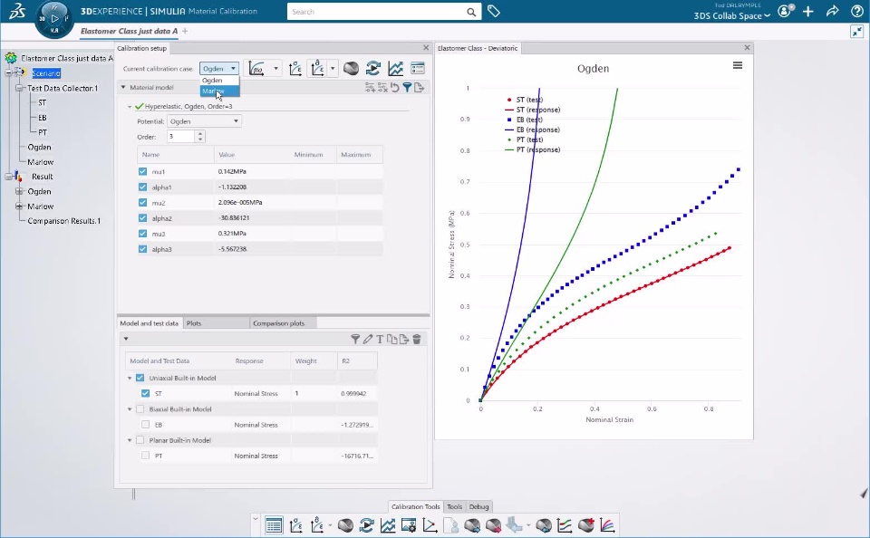

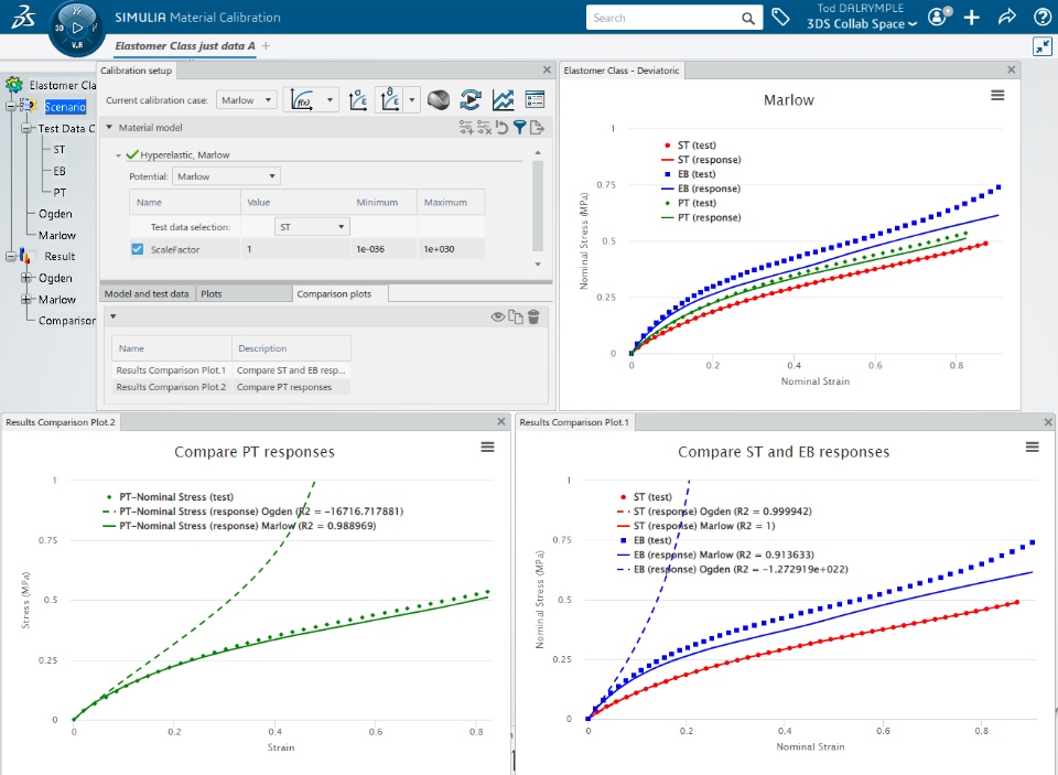

For the R2023x FD01 release of the material calibration app (Feb 2023), we have added a new capability to compare two or more material model calibrations.  In the image above, we used some elastomer test data and created both an Ogden model and a Marlow model calibration to the same test data.   The user can create additional plot windows to compare various responses.  The user can create as many "calibration cases" as desired - though of course managing all the responses becomes more time consuming.
The video below shows how one would use this new capability. In the video we show it used in analytical mode, but it may be used in any of the calibration modes.
