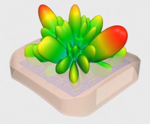

The antenna department has designed a 5G small cell antenna array with the correct radiation characteristics. The designer creates different housing variants for the given antenna array, which have to be validated for aerodynamic and thermal performance. The goal is to fulfill temperature requirements while simultaneously maintaining the electromagnetic behavior, and requires both electromagnetics and fluid dynamics simulation.

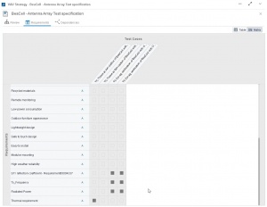

To avoid late-stage failures or unsatisfied customers, the verification & validation team needs to test the product versus requirements. This can be a virtual or physical test. However, it is important to have a sufficient number of tests, without unnecessary duplicates. The Test Manager role is of great help here, as it gives visual feedback in form of a matrix showing requirements assigned to a test case and identifying untested ones. The test cases can hold additional data, such as simulation files, documentation of test procedures, and more. Considering that verification and validation are a major part of product development, covering all necessary tests while simultaneously avoiding unnecessary ones, leads to better efficiency and increased profitability.

In this example, the thermal behavior of the two housing cases is evaluated with the native Fluid Dynamics Engineer role. The electromagnetic results are obtained with CST Studio Suite, which connects to the platform. Web-based platform apps then visualize the results, so that engineers can communicate them to non-experts in their team.
In this example, the thermal simulation uses a steady-state Reynolds-Averaged Navier-Stokes (RANS) computational fluid dynamics analysis, and the electromagnetic simulation uses a 3D full-wave transient analysis based on the Finite Integration Technique (FIT).
The results show that the closed housing violates the temperature requirement, in contrast to the open one.  Both variants maintain the electromagnetic behavior as intended.
