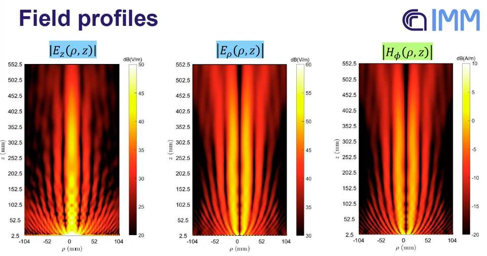

Leaky-Wave Antennas (LWAs) are a cost-effective, efficient solution to the longstanding problem of a simultaneously low-profile and highly directive radiating device. As the name suggests, the working principle of such structures is based on the power leakage during the field propagation in partially open waveguides. This phenomenon can be efficiently described through a fully analytical approach, providing a straightforward yet effective method for characterizing and designing LWAs.
In this contribution, the abovementioned analytical methods are corroborated and supported by computational analysis for investigating diverse, innovative radiators based on leaky waves. Just to name a few, low-profile, single-feeder devices able to generate, in the near-field region, focused, limited-diffraction beams for wireless-power-transfer and imaging applications will be discussed, as well as LWAs, in the far-field region, capable of radiating a pencil beam at broadside over a wide bandwidth or a frequency-scanning, directive conical pattern.
Simulations on CST Microwave Studio are specifically exploited both in the design steps (by characterizing the constituent elements of the radiating devices and by retrieving the dispersion curves of the modes in propagation in the abovementioned partially opened waveguides) and in the validation part of the structure (by observing the far- or near-field radiation pattern, polarization purity, and the antennas’ insertion loss).
