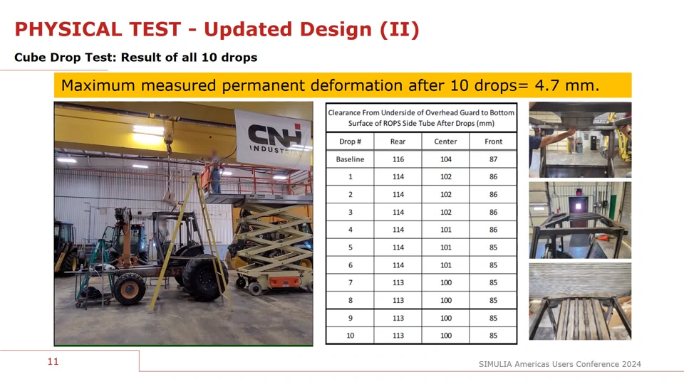

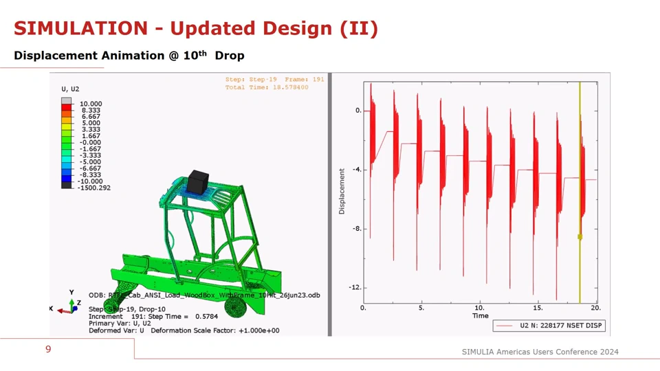

This paper introduces an innovative approach in the field of Computer-Aided Engineering (CAE) for enhancing the safety and efficiency of heavy construction and off-highway vehicles. The primary focus is on improving Roll-Over Protective Structures (ROPS) and Falling Object Protective Structures (FOPS) through advanced simulation techniques. The traditional method of ensuring the integrity of these safety features heavily relies on physical destructive testing, governed by ANSI/ITSDF B56.6 standards. However, this research proposes a novel use of the Abaqus CAE platform to simulate multi-impact scenarios using a dynamic implicit solver, which offers a more time-efficient alternative to the Abaqus explicit method, particularly for simulating ten consecutive impacts of a cube.
The study details a simulation protocol where a 45kg test cube is dropped ten times from a height of 1500 mm onto the protective structures, aligning with the standard's requirements. The goal is to limit permanent deformation to less than 18 mm without structural fractures, as mandated in ANSI/ITSDF B56.6-2011, section 8.16.3. The research provides a comprehensive comparison between the simulated results and those obtained from traditional testing methods, demonstrating a high correlation in terms of permanent deformation outcomes.
The findings highlight the potential for significant reductions in cost and time during the product development cycle. They also confirm the reliability of CAE tools in predicting the structural integrity of ROPS and FOPS under real-world impact conditions. This paper suggests a paradigm shift in the methodology of heavy machinery safety testing, promoting more efficient and equally reliable alternatives to physical destructive testing.
