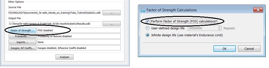

This analysis option can be selected by clicking on Factor of Strength (in the Fatigue from FEA dialogue) -> Perform Factor of Strength (FOS) Calculations

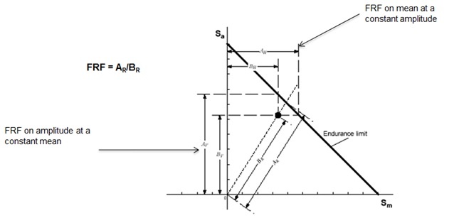

The Fatigue Reserve Factor (FRF), also referred as the Fatigue Reliability Factor, is a linear scale factor obtained from mean Stress diagrams such as Goodman, Gerber etc. They are used to calculate stress based fatigue safety factors (FRF) for a specified life.
The ratio of the distance to the infinite life line and the distance to the cycle (Sa, Sm) is calculated for each extracted cycle, to produce four FRF types – horizontal, vertical, radial and the worst of the three.

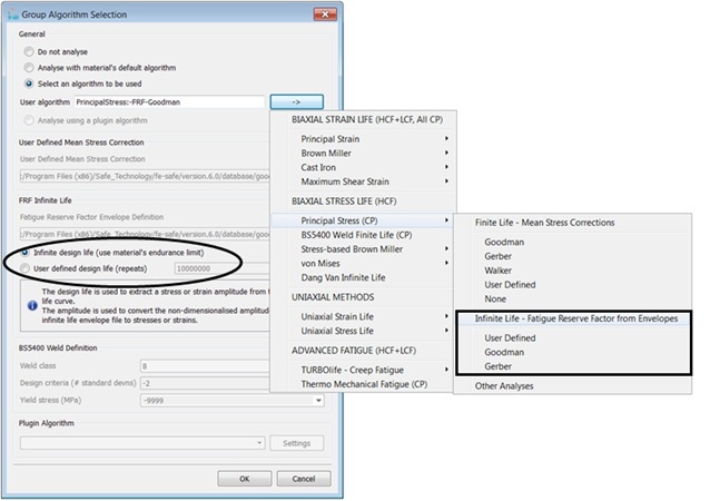

The analysis option is selected from the drop-down menu within the user-defined algorithm in the Group Algorithm Selection dialogue box.

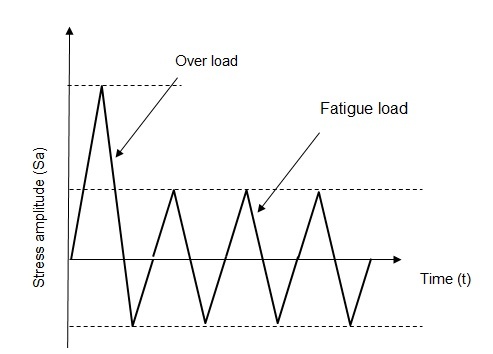

  1. There are problems with FRF calculations when designing for finite life with complex loading amplitude. For example, consider a scenario of an overloaded vehicle hitting a curb. Here, a loading cycle can be defined by a high level load followed by multiple cycles of constant amplitude low level load depicting in-service load. Say the target design life is 10e5 loading cycles.

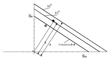

The most severe cycle (shown black) i.e. the one that comes close to the Goodman line is plotted on the Goodman diagram and the factor of strength (FRF) is given by the ratio A/B. Currently, the smaller cycles (shown grey) are non-damaging as the stresses are within the endurance limit. However, the low amplitude cycles will be damaging when scaled up by calculated FRF. The FRF analyses DOES NOT re-scale the stresses and DOES NOT re-calculates the fatigue life based on the scaled stresses. It simply calculates the scale factor once based on the most damaging cycle. For this reason, using Factors of Strength (FOS) is strongly recommended instead of FRFs.

  • Available only for Principal Stress/Strain, Brown-Miller, and von Mises algorithms
