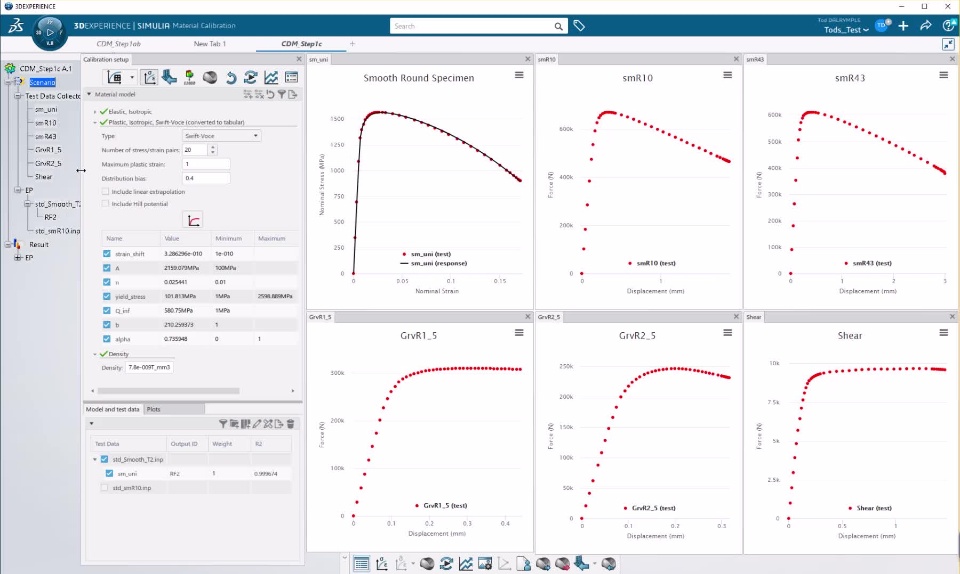

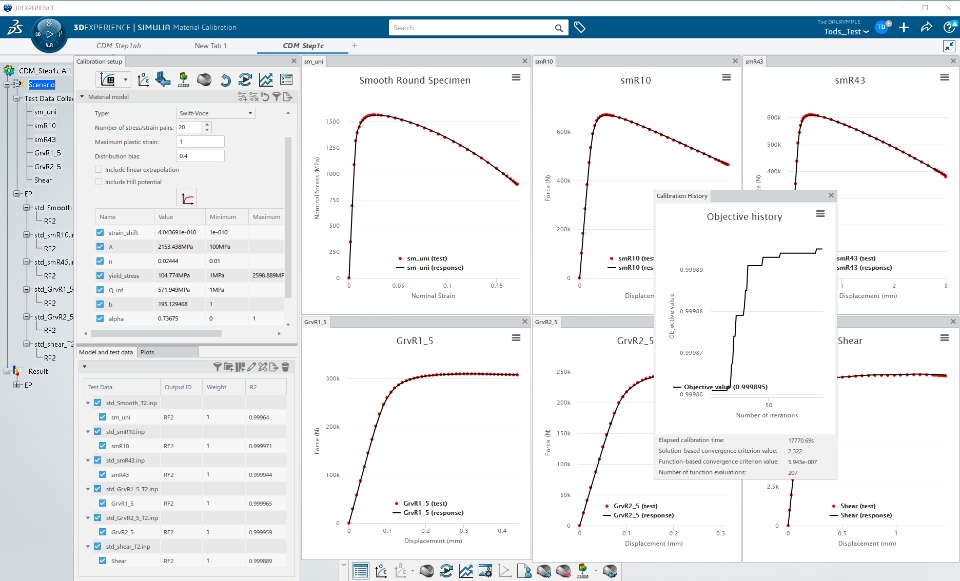

In the previous steps we have created an elastic-plastic model from the uniaxial smooth round specimen.  In general, you then want to take that material model and refine it using all of the test data available.  In this example case, we have a total of six data sets.
