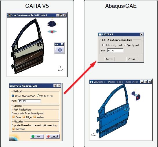

Hi All,
While using the CATIA V5 associative interface, it is essential to deactivate the parts in CATIA V5 if you do not wish to export a particular part to Abaqus/CAE. Unfortunately, hidden parts are still exported to Abaqus/CAE.
Thanks
Srikanth
