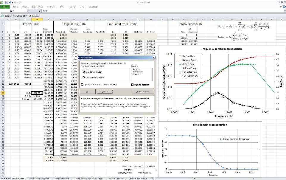

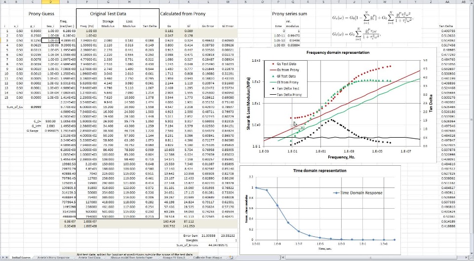

I have set up a general purpose Excel spreadsheet for calibration of Prony coefficients from DMA test data. The spreadsheet is attached to this post, and there is a narrated video used to explain the contents of the spreadsheet.  There is a worksheet used to store the test data, another worksheet is used to hold the Abaqus material model from the paper.  Another worksheet holds the response from using A/CAE to calibrate the Prony series, and another worksheet shows that response in plotted form.

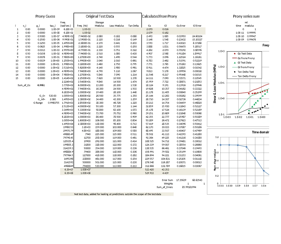

The worksheet that is used for the general purpose calibration is the first worksheet (leftmost) and is named "Initial Guess".  It is named initial guess, because the approach used is to:
a) create an initial guess of the Prony terms of g_i and tau_i ;
b) use known equations to calculate the storage and loss modulus from the initial Prony guess, and
c) construct error measures between the test data and the calculated response.
d) Then an optimizer would be used to minimize the error measure(s).
I have used both the Excel optimizing solver and Isight to minimize the error norms. The 2nd video below explains the use of the Excel solver, and when it works, it is quite easy to use and fast.  After running an error minimization process, I typically write out a new spreadsheet in which the coefficient values have been overwritten on the "Initial Guess" worksheet.

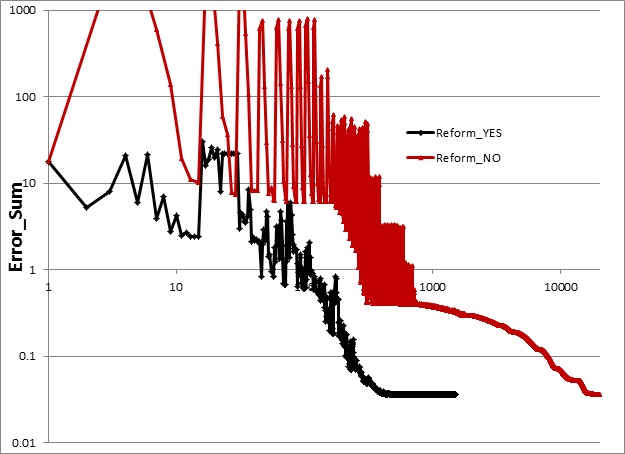

Reformulation of the Basic Design Variables
In the initial version of this spreadsheet, the tau's were fixed (one tau per decade of test data) and the g's were the design variables.  When cast in this way, one must also constrain the sum of the g's to be less than 1.   In reviewing this spreadsheet, my colleague, Malik Kayupov, suggested a clever reformulation: create a new set of design variables, x_i, where each x_i lies between 0 and 1.  Calculate the g's from these new design variables in such a way that the constraint of sum of g's < 1 is automatically satisfied.  The power of this reformulation is that the minimization process converges much more quickly.  One particular example is shown in the image below, the red line (Reform_NO) shows the minimization process over 20,000 iterations.   The reformulated problem is shown in the black line (Reform_YES) and it converges to a slightly lower minimum in 1,521 iterations - over a 10x time savings!

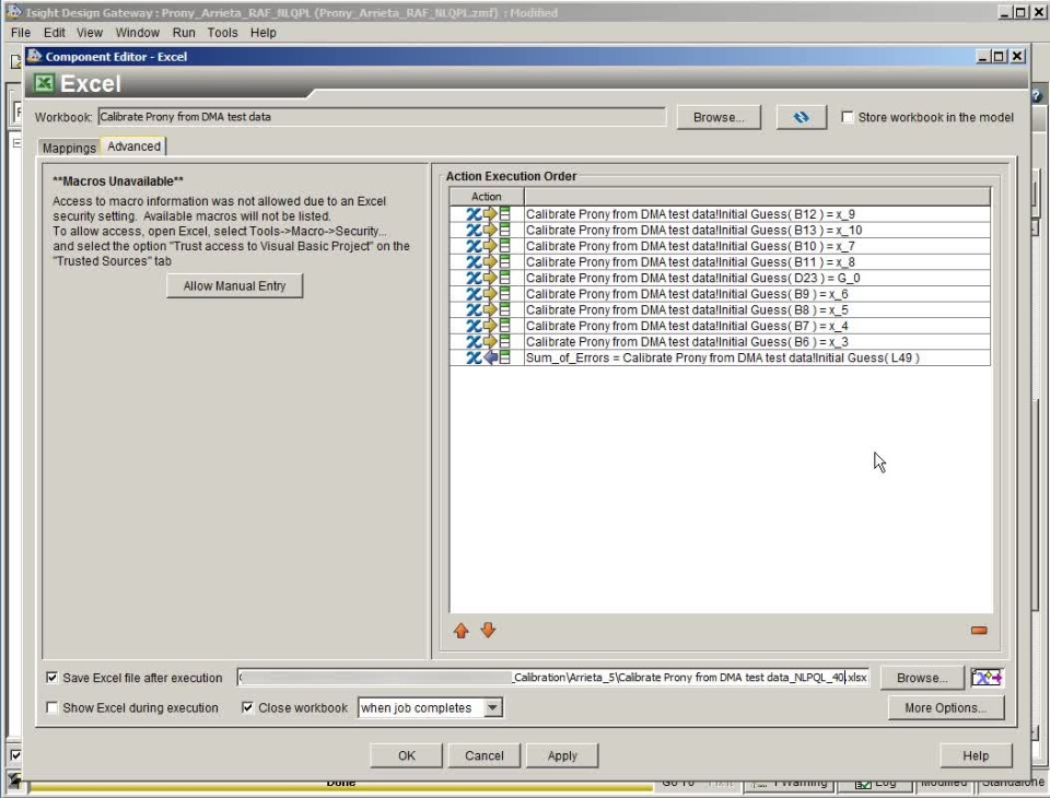

Bonus video - setting up an Isight optimization of the Excel spreadsheet:
