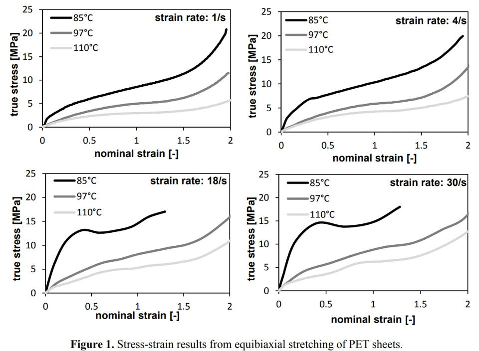

This post includes references to and figures from the paper :
Method for the evaluation of stretch blow molding simulations with free blow trials
Johannes Zimmer, Markus Stommel   Chair of Polymer Materials, Saarland University, Saarbrücken, Germany
  • November 2013  IOP Conference Series Materials Science and Engineering 48(1)
         DOI:10.1088/1757-899X/48/1/012004
         License  CC BY 3.0
Source:  https://iopscience.iop.org/article/10.1088/1757-899X/48/1/012004/pdf
This paper by Zimmer and Stommel is licensed under a Creative Commons Attribution 3.0 license, see http://creativecommons.org/licenses/by/3.0/.

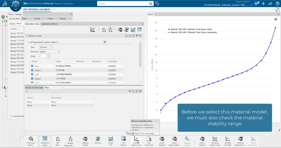

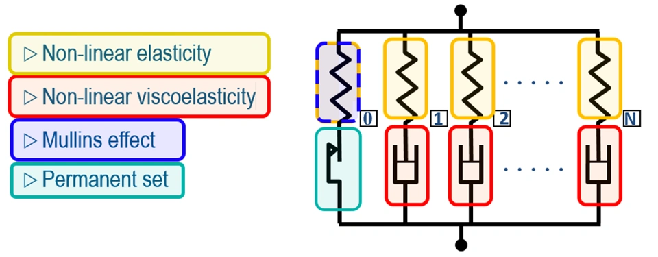

This calibration work was carried out by my SIMULIA colleagues, Stuart Nixon and Matthew Knight, starting with digitization of the biaxial test data from Figure 1 of the paper cited above.  The target material model for this work is the Abaqus PRF model.  In this use case, the Mullins and Permanent set features are not used.
These PowerPoint slides give an overview:
Video of the calibration workflow:

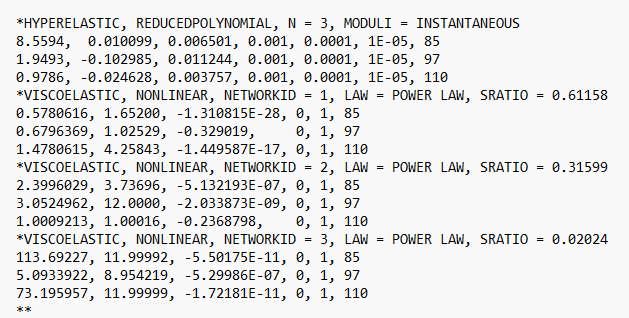

The resulting PRF material model looks like this:  (units are N, mm, MPa, degrees C)
The zip file below contains:
An Excel file of the digitized data
A .3dxml file of the final state of the calibration (can be opened in R2024x and later of the 3DExperience platform)
An Abaqus .inp file snippet of the final PRF material model
