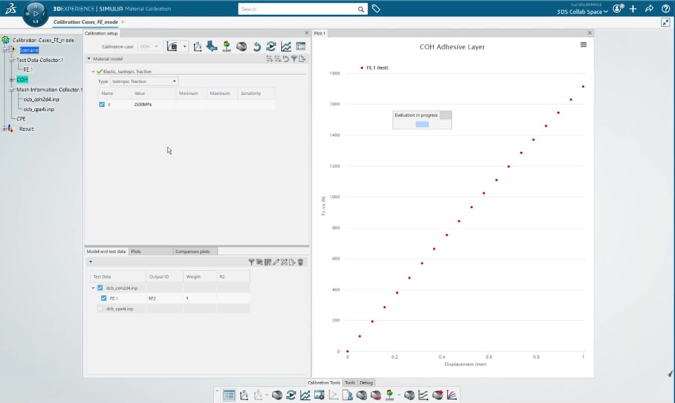

The image above is from a worked example showing a new feature called "Calibration Cases".
For the R2023x FD01 release of the material calibration app (Feb, 2023), we have added a new capability to compare two or more material model calibrations. This new feature was motivated by customers' requests for the ability to compare two different material models, as shown here: Compare two or more material model calibrations
This new feature was implemented in a more general way. When used in the FE mode of calibration, this feature can be used to compare two (or more) FE model responses. I was performing some calibrations of an adhesive layer. In order to double check some modeling constructs I decided to make two FE models:
1) Use COH2D4 elements and *Elastic, type=Traction to model the adhesive layer.
2) Use CPE4I elements and *Elastic to model the adhesive layer.
I had seen some slightly nonlinear behavior from model #1 and wanted to double check the source of the non-linearity.
Another way this new feature could be used: Import two different FE models, one coarsely meshed and one finely meshed. Use the fast-running coarse mesh to do the majority of your calibration activity and then use the fine mesh to do only a validation last step (or a follow-on small amount of calibration).
In the narrated video below, we follow these steps to prepare our calibration:
- Import test data, just one set of test data will be used.
- Import both FE models.
- Rename the 1st case as COH
- Create the second case, name it CPE
- Switch back to first case. Create an output request on the model you need (cohesive model).
- Create the material model ; Elastic, Type=Traction
- Evaluate.
- Switch to second case.
- Create an output request with the model you need (plain strain, CPE4I).
- Create the material model ; simple isotropic Elastic
- Evaluate
- Create Results Comparison Plot
- Add damage to the Traction-Separation material model.
