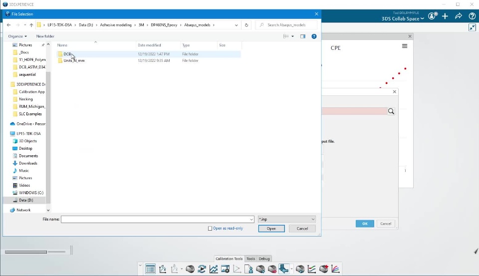

In the narrated video below, we follow these steps to prepare our calibration:
  1.  Import an already prepared single case calibration, named COH_Traction
  2.  Create the second case, name it CPE.  Rename the title in the plot dialog to CPE
    1.  This 2nd case is created by copying the 1st case
  3.  Change the material model to Linear Elastic
  4.  In the Spec Tree, delete the RF2 associated with this CPE case.
  5.  Import the Abaqus model file for use in this 2nd case, named dcb_cpe4i.inp
  6.  Map the RF2 model response for this model to the test data
  7.  Evaluate
