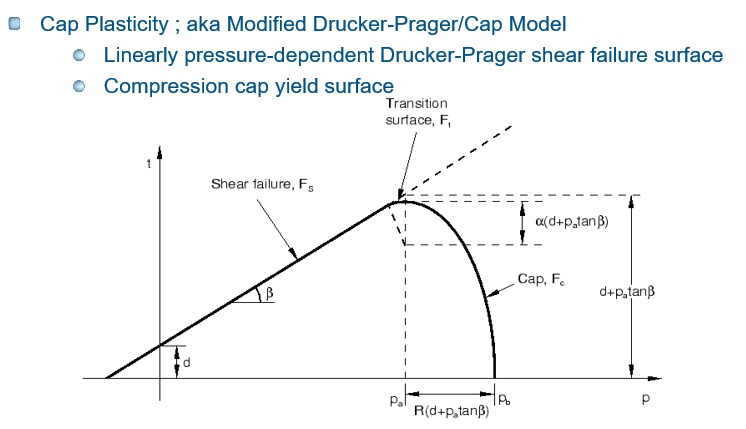

The image above comes from the Abaqus documentation for *CAP PLASTICITY
The Abaqus Benchmark manual problem "Limit load calculations with granular materials" was used as the source for this realistic Cap Plasticity material model for sand.
Units are English: Inch, Pounds (lbf), psi. You should change your display units, and your app units to these units.
The Drucker-Prager/Cap model adds a cap yield surface to the modified Drucker-Prager model. The cap surface serves two main purposes: it bounds the yield surface in hydrostatic compression, thus providing an inelastic hardening mechanism to represent plastic compaction; and it helps control volume dilatancy when the material yields in shear by providing softening as a function of the inelastic volume increase created as the material yields on the Drucker-Prager shear failure and transition yield surfaces. The model uses associated flow in the cap region and a particular choice of nonassociated flow in the shear failure and transition regions.

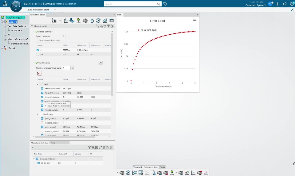

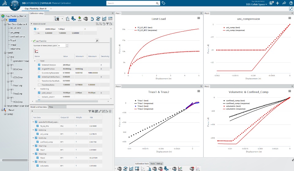

The image below is the starting point of an example calibration. Some parameters were held fixed at their known value, while others were perturbed from their known value. In the plots, synthetic test data is shown with symbols (solid circles) and the material model responses are shown as solid lines.
The video below starts from scratch and shows the process of setting units, importing test data, importing a FE model, and then mapping between the FE output to the test data. The parameters are perturbed from their known values and then a calibration performed.

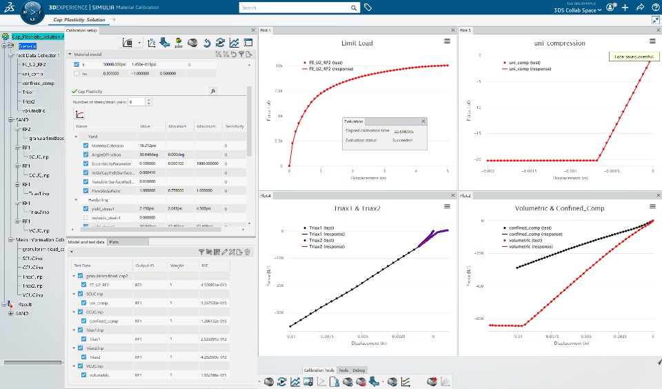

The image below is the known solution. The material model snippet file, granularlimitload_mat_mod.inp, was imported into the calibration app and an Evaluation run. Note the very small RSE error norms.
Known Solution (from the Benchmark manual problem)
** Units: English, Inch, Pounds, psi
*MATERIAL,NAME= SAND
*ELASTIC
30000.,0.3
*CAP PLASTICITY
16.212, 30.64, 0.1, 0.00041, 0.01, 1.0
*CAP HARDENING
2.15, 0.0000
20.96, 0.0005
46.60, 0.0010
79.67, 0.0015
126.28, 0.0020
205.95, 0.0025
311.27, 0.0028
655.60, 0.00299
