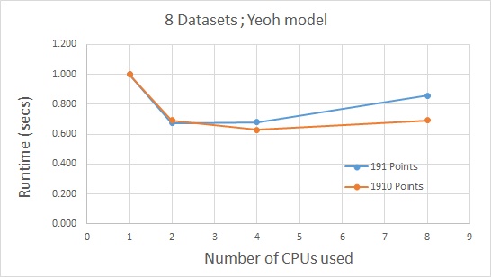

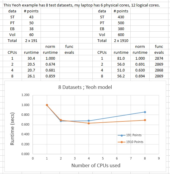

Performance testing example, using numerical mode and multiple cpus:
I started this example with our elastomer class data.  It consisted of 4 datasets, but I duplicated each dataset to bring the total to 8 datasets.   Then I tested the performance when running a Yeoh calibration on 1, 2, 4 and 8 cpus.  After the initial testing (left columns in the image below), I then used the regularize feature and made each dataset larger by a factor of 10.  The testing with these larger datasets are shown on the right side of the image below.
Take-away #1: When using multiple test datasets in numerical mode, even with small datasets there is a appreciable performance speedup from using 2 cpus.
Take-away #2: For small and medium sized datasets, when calibrating a simple material model like the Yeoh model, there is no further performance gains as one moves to more cpus.
This testing was performed using the public cloud, R2023x HotFix 3.11

I had also done some numerical mode testing in which I had 9 DMA storage modulus datasets and calibrated a hyper+Prony+TRS material model.  The DMA datasets were larger than those used above.  In that testing, there were performance gains using cpus=9 (using my laptop that has 6 physical cores and 12 logical cores.)
