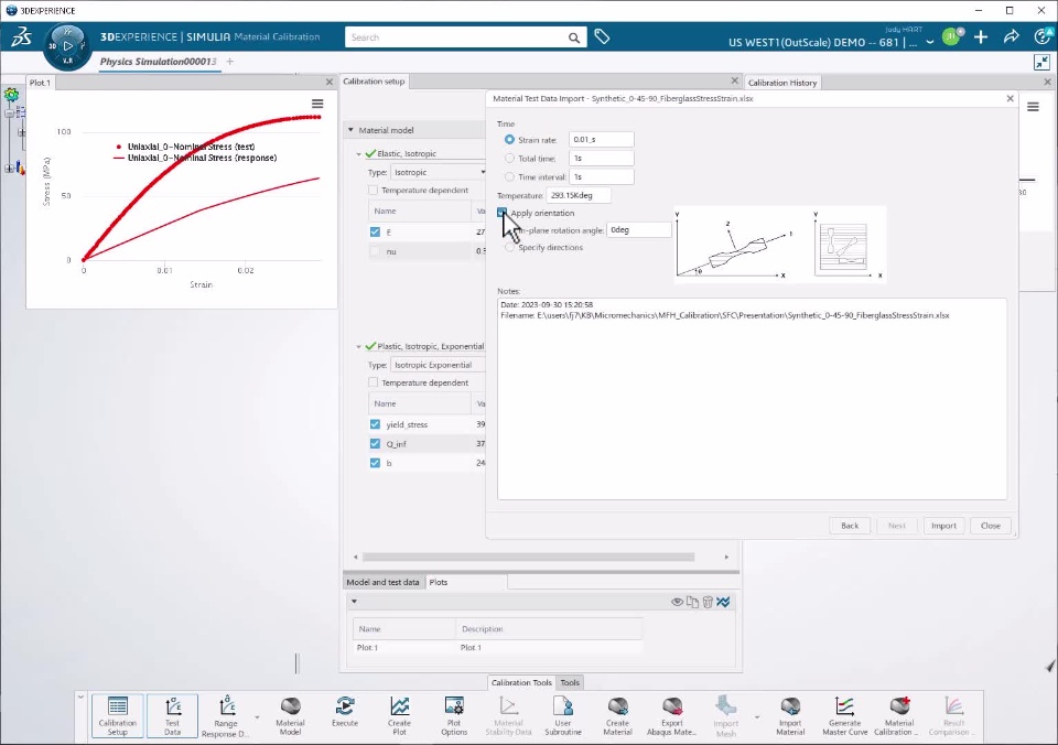

This video uses the Material Calibration app of 3DEXPERIENCE to calibrate the material properties of a short fiber injection molded fiberglass composite for mean field homogenization using test data for isotropic epoxy first, and then using test data from 0-, 45, and 90-degree dogbone specimens of the composite.
