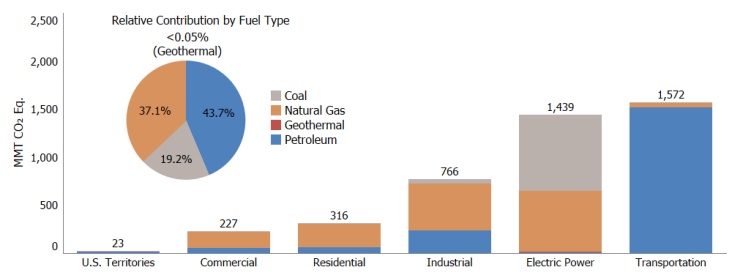

Drastic climate changes are pushing the demands for greener solutions day by day. In the US, petroleum combustions in the transportation sector contribute approximately 43% of total CO2 emissions while CO2 contributes to approximately 79% of all the greenhouse gas emissions[1]. This highlights the importance of reducing the dependence on petroleum combustions for transportation. Promoting electric transportation is already showing a major impact on the comparison of emissions. Battery, being the most important component of all-electric mobility solutions today, needs extra attention to develop safe, secure, and lightweight designs with high energy outputs. Battery development involves multi-physics phenomenon to be simulated and tested for efficient performance for all-weather operations.
Figure 1: 2020 CO2 Emissions from Fossil Fuel Combustion by Sector and Fuel Type in the United States

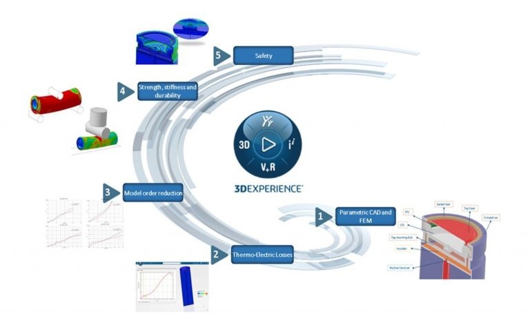

At SIMULIA, all non-linear multi-physics phenomena are modeled and analyzed in great detail using state-of-art Abaqus technology. The 3DEXPERIENCE platform helps in democratizing the simulation technology by accelerating early adoption and integrating all the business aspects to provide a unique value proposition. In these workflows, the battery cell is analyzed for its thermal, electrical, structural, and safety characteristics. Let’s have a look at different simulations one by one.
  • Electrical Safety – A coupled electrical-displacement analysis is performed to simulate electrical circuit cut-off for preventing short-circuit events by modeling a circuit-interrupt-device (CID). A detailed parametric cell model is used in the analysis with mesh-associated CAD. This makes it easier for designers to simulate different cell variants in a single click.
  • Cyclic Swelling – During charging-discharging events, a cell undergoes permanent plastic deformation. This is calculated by simulating coupled electrical-displacement behavior for active electrode layers inside the cell. Evaluation of the displacement in thickness direction over charge-discharge cycles is carried out using SIMULIA Abaqus user subroutine UEXPAN. It considers the thickness change based on the measurement of each active layer during charging and discharging.
  • Heat generation – The simulation evaluates heat generation during electrical discharging of the Li-ion battery. The mathematical formulation takes into account joule heating and heat generation due to entropy change based on the direction of the current in active electrodes.
  • Strength, stiffness & durability – Set of standard simulations are performed on the battery cell to evaluate the structural integrity of the battery cell. These simulations include 3-point bending, axial and radial compression, and impact analysis. A structurally homogenized battery cell model is used to perform this analysis and evaluate stress-strain levels for specific boundary conditions.
Figure 2: Battery Cell Engineering Solutions
