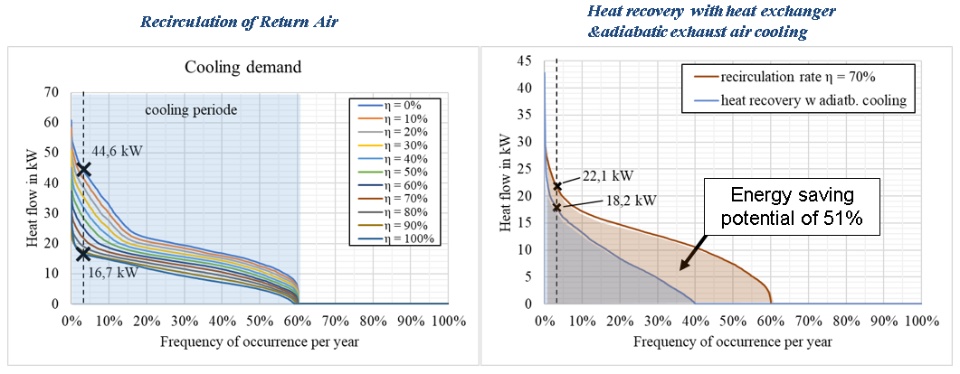

A simulation with 100% air recirculation and space cooling of the building is carried out with the coupled building & HVAC system model. Yearly results allow estimating the cooling power required at 15kW to cover 90% of the cooling needs, for specific operational conditions of the AHU (volume flow of 7500 m³/h, with maximum target temperature of 26°C and the nominal supply air temperature of 20°C). Lowering the supply inlet temperature to 15°C requires a cooling power of 28kW to cover 99% of the yearly cooling needs. Recirculation of return air decreases the cooling needs but is not suitable when considering spreading of harmful particles. A highly efficient alternative is to use a heat recovery unit. The interior air quality (IAQ) is then also improved since 100% fresh air is supplied to the building with a heat recovery unit. Figure 1 shows the cooling demand over the year with recirculated air & recovery unit.
Figure 1. Cooling demand of the office building & fan sizing over the year depending on recirculation rate and heat recovery unit

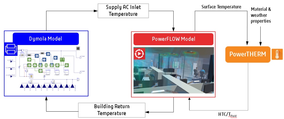

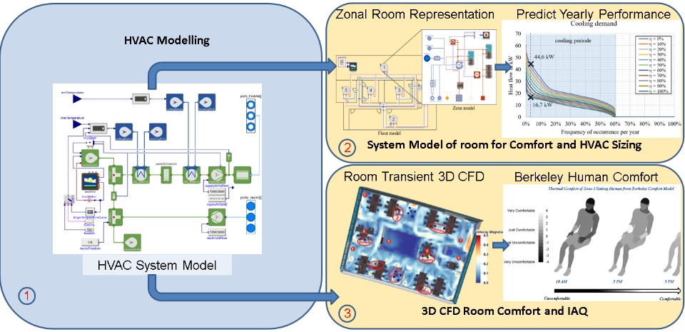

In the integrated simulation, the System model representation of the office room (2) is replaced with a 3D CFD model (3), whilst the complete HVAC layout (1) from System Model continues to be modeled as shown in Figure 2.
Figure 2. Overview of System Model & 3D CFD Model for Integrated & Standalone Simulations
The PowerFLOW-PowerTHERM 3D CFD simulation coupled with the Dymola System Model is carried out for a period of 12 hours, from 7 AM to 7 PM with occupants inside the building. The effects of solar radiation, ambient temperature, ambient humidity and sun position are included. The coupled simulation , including Berkeley human comfort modeling, is carried out to match the worst day investigations from the System-Model results, with identical boundary conditions. The flow simulation shows the effect of diffuser on the flow behavior inside the building wherein the cold dense air from the diffusers falls directly to the floor before rising up. This leads to less diffusion close to the ceiling, with most of the flow mixing occurring at the floor level. During the coupled simulation, the properties are dynamically changing and updated with time. The controller in the System-Model stabilizes the temperature and reduces the oscillation in the output after each coupling. The integrated PowerFLOW-PowerTHERM model is shown in Figure 3.
Figure 3. Integrated PowerFLOW-PowerTHERM Model with Reduced System Order Model

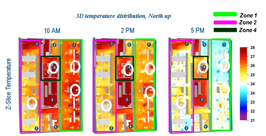

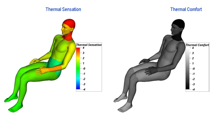

The fluid temperatures in the 3D model were found to be 1 to 2K higher than for the System-Model for certain zones. The main difference is more due to localized impact of solar radiation and flow currents. Local spatial and transient temperature changes with varying solar load and its effect on thermal comfort can be clearly captured in a 3D simulation. In the morning, higher temperatures are seen in the parts of the building mainly Zone 1 where the solar load is the greatest and it decreases as the sun moves to the other side. Asymmetrical temperature variations are also captured well and 2 humans sitting on different ends can experience drastically different comfort levels as a function of the balance of solar radiation and vent positioning. The impact of localized temperature and solar load can be seen on the thermal comfort of the occupants. The local comfort of the worst body parts affects overall comfort. For example, occupants in Zone 1 receive lot of solar radiation in the morning increasing the skin temperature and the local thermal sensation of head and neck. Hot thermal sensation and high discomfort can be seen for the Zone 1 human in Figure 4.
Figure 4. Thermal Sensation & Comfort of Zone 1 human at 10 AM
The head and neck are very uncomfortable and it brings down the overall comfort for the certain time as shown in Figure 5. The zone 2 occupant, sitting away from the window and receiving good air flow, and the Zone 4 occupant, sitting in a convection dominated area are just comfortable throughout the day. Different Zones and occupant positions (represented by circles) are shown in Figure 5.
Figure 5. 3D Temperature Distribution, North-Up

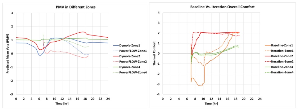

As per ASHRAE, Predicted Mean Vote (PMV) is the most recognized thermal comfort metric used for building simulations. However PMV provides accurate predictions mostly in uniform controlled environments, and considering the body as a whole. Results that show local asymmetry of temperatures, with transients and high thermal gradients, require advanced comfort algorithms to determine thermal comfort. As seen in Figure 6, the zonal System-Model PMV is in agreement with local CFD PMV for Zone 4, a zone which demonstrates less thermal gradients & solar load. But in more heterogeneous zones like Zone 2, a higher difference is observed due to zonal averaging in the System-Model. Similarly, comparisons between local CFD PMV & the more advanced Berkeley comfort model show that the high discomfort observed for occupants in Zone 1 is better captured with the Berkeley model than with PMV. Lastly, the System-Model indicates that solar load should be reduced everywhere in the building, whereas the 3D CFD Berkeley model indicates that this needed only for certain zones, reducing construction material cost.

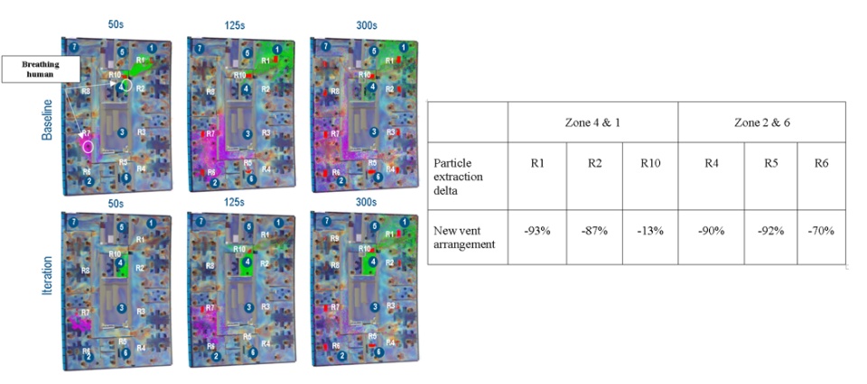

The importance of 3D simulation to predict the air quality concurrently with thermal comfort is studied for 2 talking humans emitting contaminated particles every 60 seconds. In a first baseline simulation, no vents are present in the conference room from Zone 4, and airflow is supplied from all the vents in the hallway in Zone 2. In Zone 2, the occupant is thermally comfortable and the particles spread uniformly, with aerosols propagated by convection. The particles from Zone 4 with no vents leave the conference room, enter the hallway carried along the flow current and accumulate across the North East of Zone 1, where another HVAC outlet R1 can extract them from the room. Although the filtering of aerosols is adequate with this configuration, Zone 4 is not thermally comfortable. Hence, HVAC flow outlets are taken from Zone 2 where there is more cold air flow than required. The revised run however leads to less particles being extracted from Zone 4. This is due to an increased flow recirculation inside the room with the vent arrangement, limiting the amount of air reaching the hallway, and being convected by the hallway current to R1 as shown in Figure 7. In Zone 2, the reduced air flow rate from the removed HVAC inlet leads to less particle dispersion and extraction by HVAC. In this specific circumstance, changes that led to an improvement in comfort and energy efficiency also increased the risk of particle contamination from unclean air.
