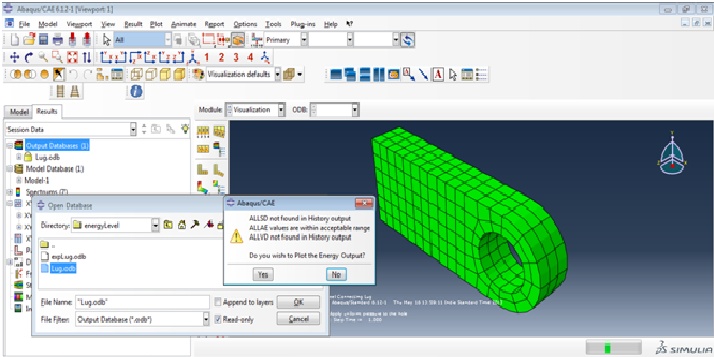

On opening an ODB file, the script checks if the energy outputs ALLIE, ALLAE, ALLVD and ALLSD are requested for the whole assembly. If the necessary outputs are available in the ODB file, the script automatically evaluates the ratio of ALLAE, ALLVD and ALLSD to that of ALLIE. A message pops up in Abaqus/Viewer, which notifies the user about each of these energy levels. The message specifically mentions the energy outputs available in the ODB file, and for the available outputs, ratio is calculated and checked if it’s within 5% of Internal Energy. If the energies are within the acceptable limit, user would be notified with a message as ‘ALLAE or ALLVD or ALLSD values are within acceptable range’. And if they are not, then the user would get another message.  For example if ALLSD values are not within 5% of ALLIE then the message would be, 'ALLSD values are more than 5% of ALLIE'

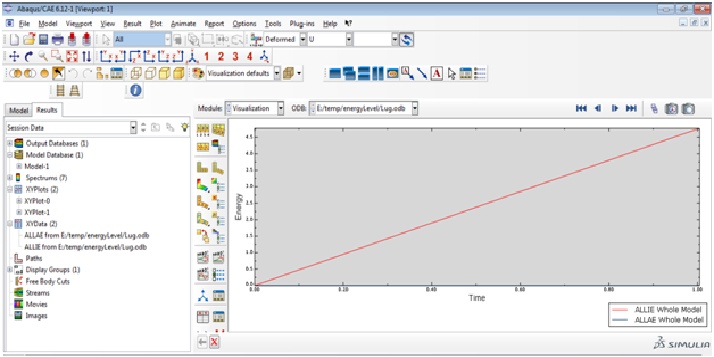

The message window also provides the user with an option to directly plot the concerned energy output in the viewport for visual evaluation. If the user chooses to plot the Energy Levels, the energy levels are saved as XY Data and plotted as XY Plot in the viewport. The XY Data is saved as output variable names along with their ODB file name. For instance, in the above example below, ‘Lug.odb’ file was opened and the energy levels are saved to the session. ALLIE and ALLAE were available in the ODB file, so the XY Data names would be “ALLIE from E:/temp/energyLevel/Lug.odb” and “ALLAE from E:/temp/energyLevel/Lug.odb”.
