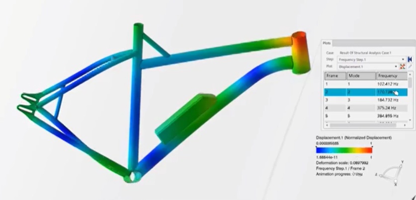

Finally, a modal analysis is set up in the Mechanical Scenario Creation app. The first choice to make is what type of analysis to run – in this case, it will be structural only. In 3DEXPERIENCE, a model can contain multiple representations – this is different from Abaqus/CAE. As well as geometry representations, there can be multiple finite element model representations.
For the modal analysis, a frequency step is implemented, followed by the simulation step. Since the cloud version of 3DEXPERIENCE is being used, the choice can be made to solve either locally or on the cloud hardware. After solving, we can see the displacement animation for the bicycle frame.
