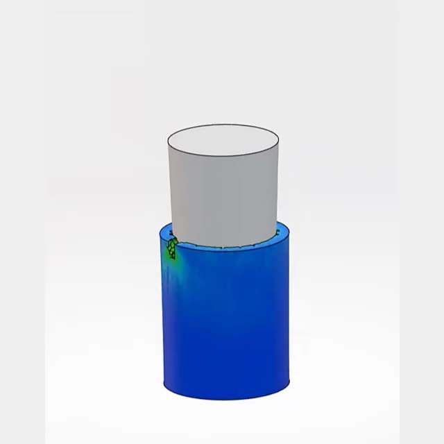

Simulation allows us to understand composite material behavior with less physical testing. We can create a finite element model of a composite material with detailed microstructure. By performing simulation with these FE models, we can predict local constituent failure, delamination, and other small-scale behaviors that cannot be easily measured in physical tests.
On a larger scale, we can use simulation combined with efficient multiscale modeling to study how manufacturing processes can affect the quality of the final product. For example, for injection molded thermoplastic parts, we can simulate the flow of the fibers during the injection process. The predicted fiber orientation can be incorporated into the material model, and the weakest locations of the part under a service load can be detected through a structural simulation. Simulation can also be used to compute the residual strain and stress from the curing process, and to predict the resulting warpage.
