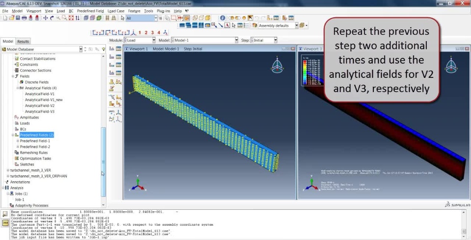

  1. Using the Abaqus output database of the CFD analysis, create three analytical fields: one each for V1, V2 and V3.
  2. Create a predefined “Temperature” field and use the  analytical field for V1.
  3. Repeat the previous step two additional times and use the analytical fields for V2 and V3, respectively.
  4. Edit the model keywords and replace *INITIAL CONDITIONS, TYPE=TEMPERATURE with *ACOUSTIC FLOW VELOCITY.
  5. Add the DOF direction to all the data lines under *ACOUSTIC FLOW VELOCITY.
