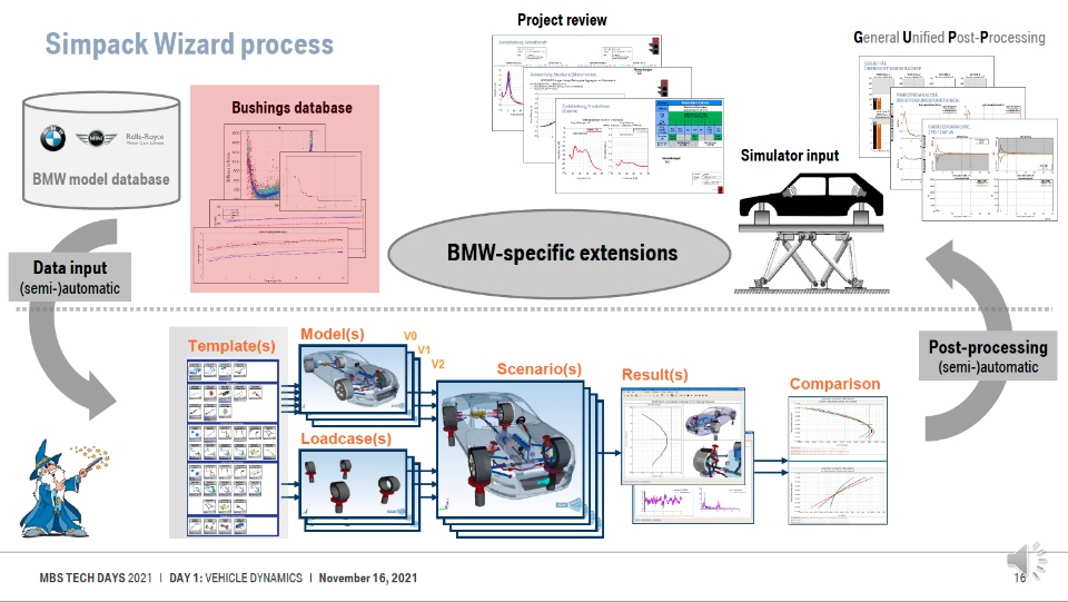

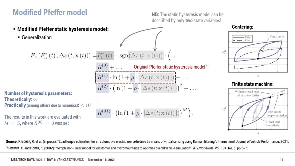

Since such BEV powertrain mounts significantly influence the vibration comfort of the complete vehicle, the elastomer mount modeling and parameterization is a crucial and challenging task. Therefore, the work at hand deals with the MBS modeling of elastomer mounts, the associated fitting, and the subsequent incorporation of complete vehicle models within Simpack MBS software.
The virtual development process regarding vibration comfort using the module Simpack Wizard and its corresponding automotive database will be presented based on a case study.
