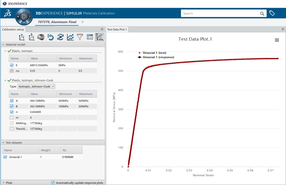

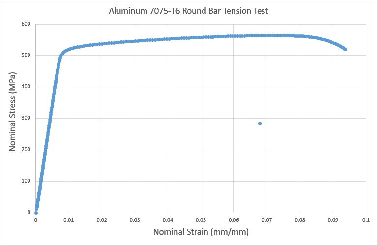

This is a post to share the raw test data for Aluminum 7075-T6.  Just a single uniaxial tension pull-test out to failure.  Prior to using for calibration of elastic-plastic material models, one should truncate the test data to end at or before the ultimate point.  Target is an elastic-plastic, Mises, Isotropic material model, such as the Johnson-Cook equational form.

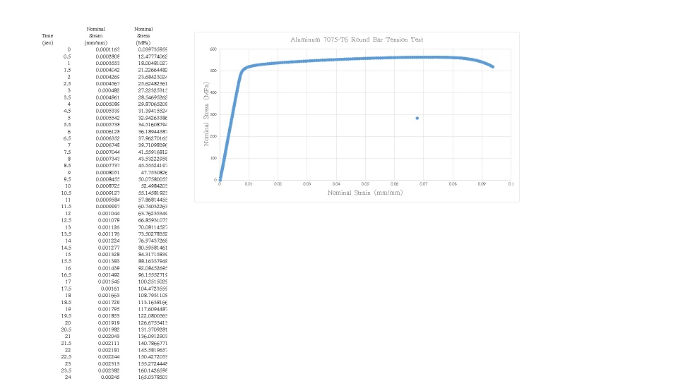

Here is the test data in an Excel file:
Here is an image of the calibration result for Johnson-Cook (cal app version 2019x FP1923):

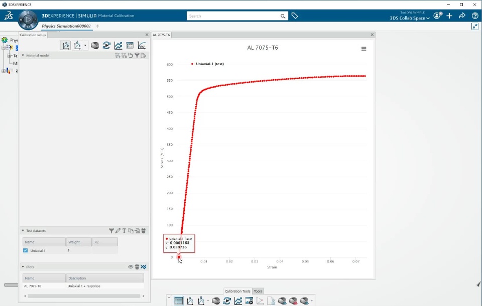

The demo video below was created using a beta version of 2020x FD04, created on June 13, 2020.
