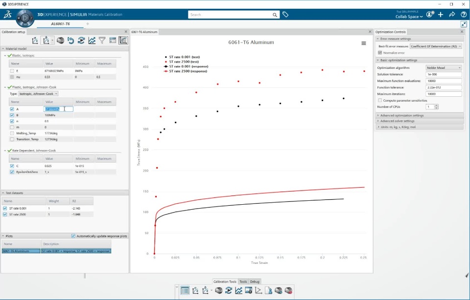

There is this paper on the internet:
AL 6061-T6 - Elastomer Impact Simulations
PI: Jacob Fish Research Associate: Coglar Oskay PhD student: Rong Fan
Program Monitor: Roshdy Barsoum
June 21, 2005
Part of that paper shows some test data for an aluminum 6061-T6 material at a strain rate of 0.001 and 2500  1/sec.  I have digitized that test data and used it here to show a calibration of a Johnson-Cook elasto-plastic model with rate dependence. This rate dependence feature of the calibration app will come out as part of the 2019x FD04 release.
