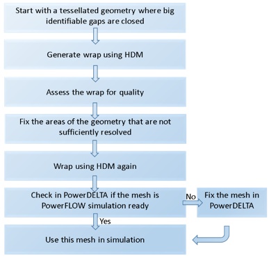

Figure 2: A generalized overview of the geometry preparation process
Acoustic simulations require the precise details of the geometry to be captured since a slight anomaly in the surface can generate unrealistic noise sources and levels. A semi-automated method has been developed that allows for the precise manual intervention but at the same time automates the non-trivial and time consuming parts of the process. Only certain targeted regions need to be corrected manually instead of the whole geometry. One can choose to work upon only flow critical parts. In a complicated geometry, it is difficult to determine the connections between parts. The method helps find out where the connections need to be made.
This method involves the use of Hex-Dominant Mesh (HDM) surface wrap which is used to generate wrap that creates a surface mesh. HDM is generates surface wrap with a single command. A generalized overview of the mesh generation process is shown in Figure 2.

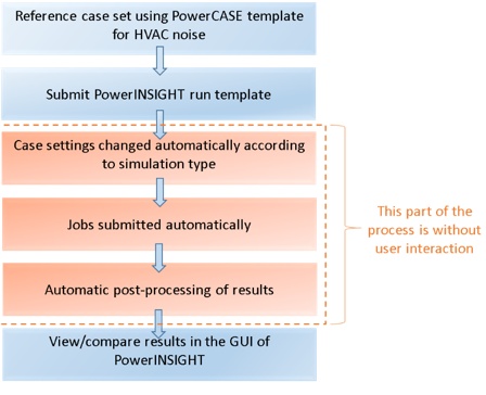

Figure 3: A generalized overview of the process using PowerINSIGHT template
The set up for acoustic simulations is complex and time consuming, and thus prone to engineering errors. Improvements to the case template were implemented to minimize engineering effort during the preparation of the reference case. A full case can be ready within a quarter of an hour from prepared geometry, with all simulation specific settings fully automated. A process template is generated in the automation tool PowerINSIGHT for these simulations, where no user interaction is required beyond the template submission through a graphical user interface (GUI). With the use of this template, the saving in overall turnaround time, including engineering and computation time, is approximately 60 hours. A generalized overview of the process using the PowerINSIGHT template is shown in Figure 3.

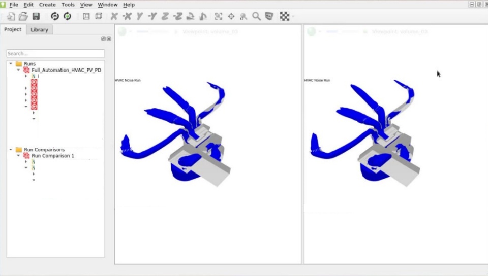

Post processing is performed automatically and results are generated as PowerINSIGHT contents. The results can be conveniently browsed in PowerINSIGHT for each simulation and a comparison of results from different simulations can be performed with ease as shown in Figure 4. This also allows for the simulations to be submitted overnight and during weekends automatically, which eliminates the time spent in waiting for the next simulation to be submitted manually.
Figure 4: Comparison of simulation results in GUI of PowerINSIGHT

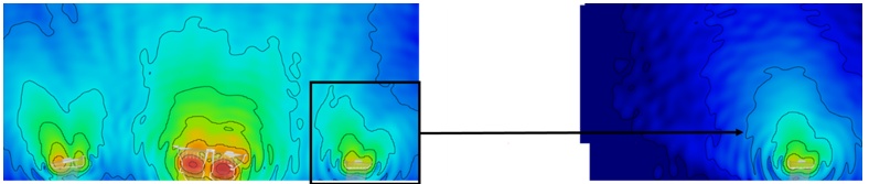

The acoustic field of the simulation outside of the ducts is well comparable, as are probes close to the respective outlets. Keep in mind, that in order to capture the full spectrum on a far field probe or at a typical driver ear position on a car HVAC system, all relevant outlets and thus ducts need to have a seeding input and need to be simulated. An example of comparison of acoustic dB maps between whole and truncated unit is shown in Figure 5.
Figure 5: Comparison of acoustic dB maps between whole unit with all ducts and registers to the left and truncated unit with just one duct and register to the right
