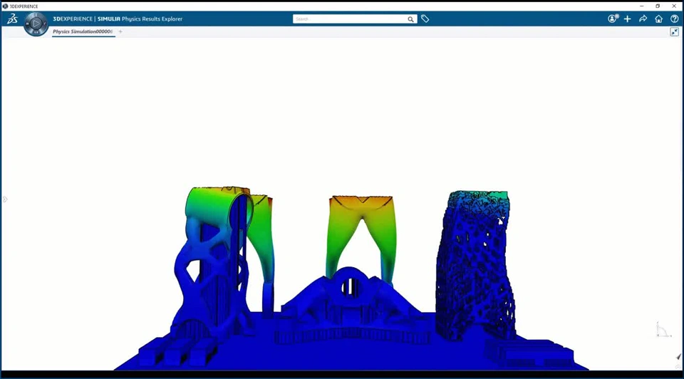

But here’s the challenge the process itself introduces thermal effects that can cause residual stresses, distortions, or even failures during service. That’s where simulation steps in.
Why simulate Additive Manufacturing?
  • Predict and mitigate residual stresses.
  • Bridge the gap between designed vs. manufactured parts.
  • Evaluate performance under real-world conditions.

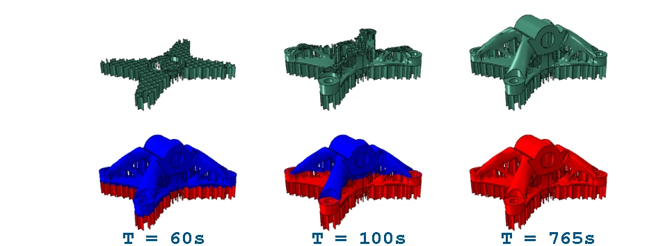

1. Thermomechanical Simulation – High-fidelity, physics-based, with heat transfer and stress analysis. Accurate but computationally expensive.
2. Eigenstrain-Based Simulation – Faster, approximate method to capture residual stresses & distortions, calibrated from experiments or detailed simulations.
3. Pattern-Based Thermal-Mechanical – Simplifies laser/toolpath definitions for powder bed processes, balancing accuracy and efficiency.
4. Direct Material Deposition (FDM/LDED) – Simulates nozzle/laser-driven processes where raw material and heat source act simultaneously.

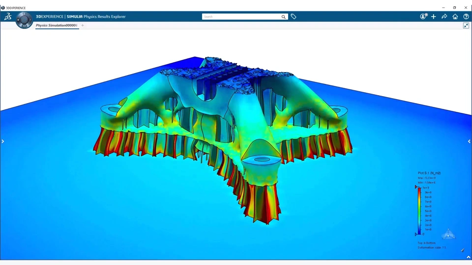

Control at Multiple Scales
  • Process-level simulations (fine meshes, small increments) capture detailed physics – but at high computational cost.
  • Part-level simulations (coarse meshes, averaged increments) predict distortions/stresses efficiently – ideal for large parts.
