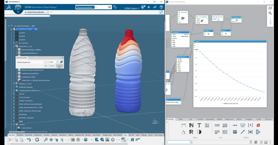

With AI-enabled MODSIM, designers can easily adjust any parameter of their design in an intuitive online interface and see the impact on structural integrity in real-time.

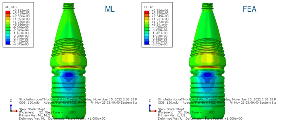

Comparison of results of a 3D FEA analysis of a bottle being crushed and the machine learning (ML) powered surrogate model.  Top: graph of buckling behavior. Bottom: 3D field plots
AI-enabled MODSIM is the next step for MODSIM, using the power of machine learning to make simulation much faster and therefore more useful for designers. With classic finite element analysis, for each design variant, the physics must be simulated again from scratch. AI machine learning can provide results for any design variant in moments and accelerates the process.
Only a few simulations covering a representative area of the design space for the packaging need to be performed. These are then used to train a neural network, which learns how the geometry relates to its physical properties. Both time transient and stationary scalar physical responses as well as 3D full field prediction can be modeled, resulting in an information-rich and much more productive environment for product design.
The resulting surrogate model is validated against further simulations, and if an acceptable level of accuracy is reached, it can then be used to calculate the behavior of the packaging for any design variant.
Using machine learning, designers can find the best trade-offs within seconds and understand the impact of a design change with real-time feedback. Exploring more of the design space can significantly shorten the package development process while achieving ambitious cost, weight, and sustainability targets. With AI-enabled MODSIM, the simulation and machine learning tools are also available in an easy-to-use interface, bringing them to non-expert users. Rather than replacing human work, AI works alongside the designer, providing instant feedback about the design.
