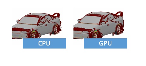

The PowerFLOW GPU solver provides the same physics as the CPU (central processing unit) solution, but executable on NVIDIA GPUs. This allows users to run small-scale problems on a desktop equipped with a GPU, or to simulate industrial-scale problems on multiple GPU systems. GPU computing reduces the expense of buying and maintaining a CPU HPC cluster, bringing PowerFLOW fluid simulation to component analysis and early concept design.

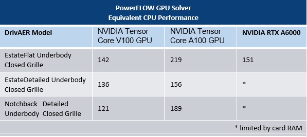

The performance of the GPU solver will vary depending on what GPU is being used and what CPU it is being compared against, but generally, one NVIDIA A100 Tensor Core GPU will replace 120-200 CPU cores. The PowerFLOW GPU solver is licensed the same way as the PowerFLOW CPU solver: no special or additional licenses are necessary to use the solver.

Using the GPU solver and Concept Aerodynamic Design Best Practices, a designer should be able to rapidly prepare PowerFLOW simulation for a concept vehicle at the end of the work day, submit the simulation and get results overnight. The solution accurately captures transient aerodynamic interaction between different parts of the vehicle with high fidelity, enabling rapid evolution of the concept design.
