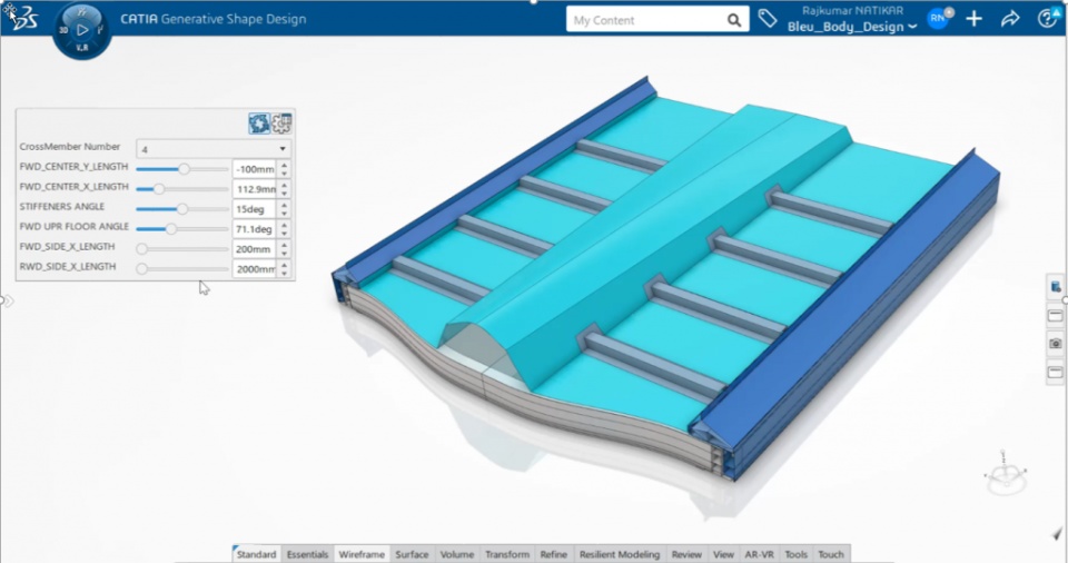

Figure 1: Floor panel design
Example of MODSIM on the 3DEXPERIENCE Platform
For this example, we will use modeling and simulation of a floor panel (figure 1) of an electric vehicle, showcasing a unified environment that dramatically improves productivity and collaboration by using the 3DEXPERIENCE platform. Every development process starts with requirements, so let’s start there. At the beginning of developing an electric vehicle, you need a lot of flexibility in the structure. For example, the batteries may not be fixed in size. The size of the batteries influences the panel itself, which has to be stiff enough to carry all the loads. And at the same time, it has to be soft on the boundaries to absorb enough energy in case of a crash. By tweaking the different parameters, we can then modify the floor panel of the vehicle.

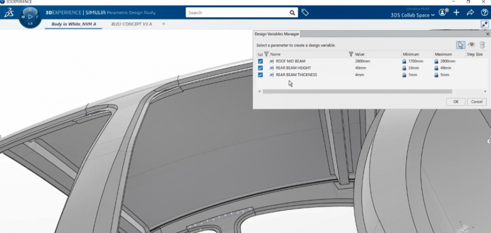

Next, let’s move forward to another example to show you exactly how you can play with different parameters. In this particular case, we will optimize the stiffness of the roof panel to be about 33 hertz to avoid any vibrations in the roof. The variables we have to do this is first to move the stiffener itself, and then modify the height and the width of the beam. Now this seems to be an easy task, so to acknowledge the challenge here, while we are moving that stiffener, it has to adapt its length to fit into the width of the roof, and at the same time, we have to update the fastener as, as well.

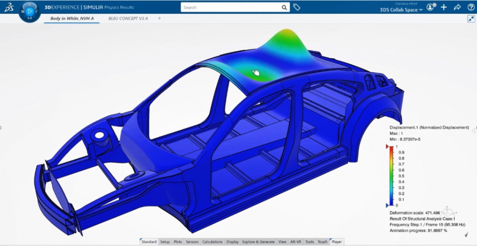

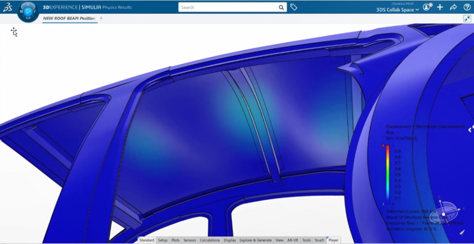

So now, we can see the results of our initial design (figure 2) and we can start our performance study (figure 3) by simply selecting different parameters such as the height, the width, and the position of the beam. Then we move through the different positions automatically to see if everything regenerates well, and this is one step before we even start the optimization process itself.
Figure 2: Initial roof design vibration mode shape
Figure 3: Performance study
Once everything works, we can find what kind of response variables we want to use. For this example, we used the displacement of the roof, the frequency, and the total mass of the vehicle.

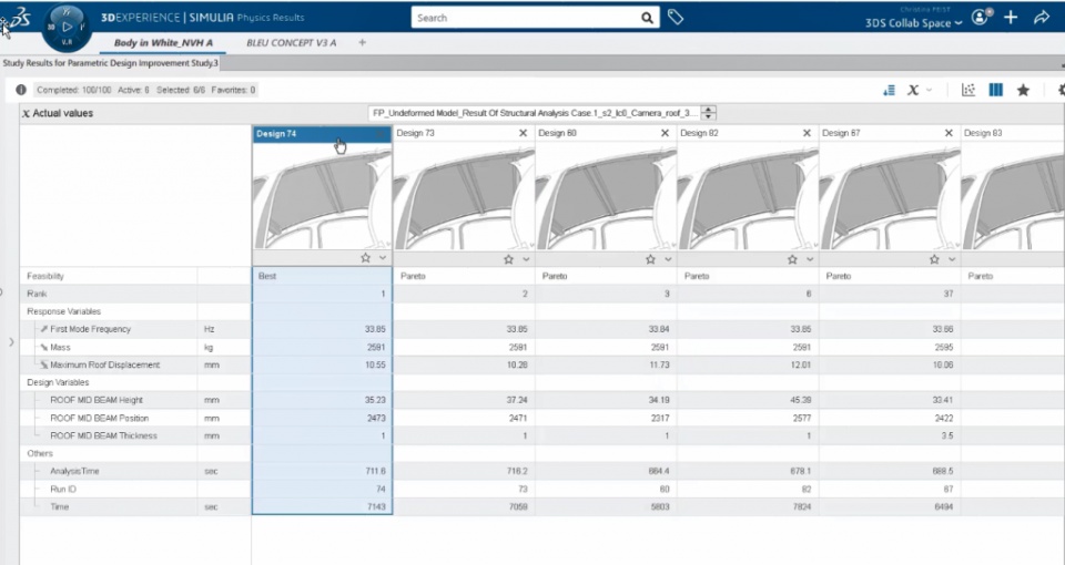

Now we launch the optimization process (figure 4). We will get multiple positions for where the stiffener could be. And now we can compare those best choices (figure 5) next to each other and then we can select which of those designs we want to use. Once a design is selected, we can store it as the new variant for that position, and we are feeding back that information and that process to our design experts.

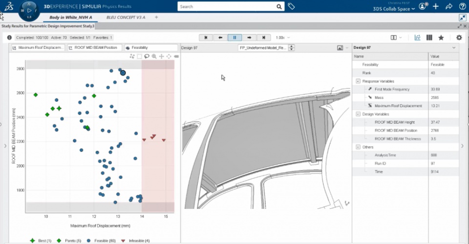

And now we can see the results of the final run (figure 6). Just a note that what we have been doing so far is within one specific domain. If we want to extend to multi-domains, we will need processes. We can create processes that can directly access all the objects within this experience and all the geometry parameters. Not only that but all the attributes of the simulation can be tweaked within the process as well. And if all those simulations are associative to that baseline geometry, you can start to do multi-disciplinary design optimization. So, we not only have the design engineer and the simulation engineer working together, there are multiple stakeholders all working collaboratively.
Figure 6: Results of the final run
