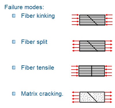

In Abaqus/Standard 2017 a new composites failure criteria was implemented as a "built-in" user subroutine.  This composites failure criteria was originally developed at the NASA Langley Research Center (thus the name LaRC).  The LaRC composites failure model has been evolving over more than a decade, and has taken names such as LaRC03, LaRC04, and LaRC05 (see papers listed below for more information).  A team lead by Professor Silvestre Pinho, Imperial College London, used the LaRC05 failure criteria in the WWFE-II exercise, and that work is summarized in the last two papers shown below.

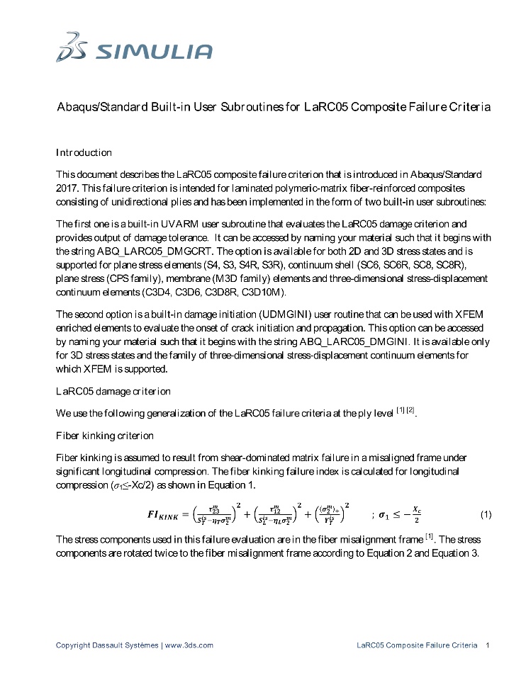

 The implementation in Abaqus/Standard 2017 is in two forms:
UVARM -A damage criteria evaluation via a built-in UVARM subroutine
UDMGINI - A damage initiation criteria for XFEM enriched elements via a built-in UDMGINI subroutine.
More details are included in the attached pdf file named QA046225_LaRC05.pdf  This doc comes from the KB article of the same name.
Some sample files that come from our QA testing are attached in the file LaRC05_input_files.zip
