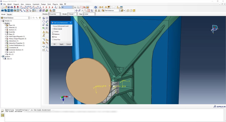

This very simple Plug-In allows to automatically set a curve refinement level for all geometrical parts in the assembly. The built-in option would require to define that for each part separately, which can be annoying. So the possibility to change it for all parts in a model with one action is quite useful.
The Plug-In data contain the source codes, so feel free to change the default settings or modify stuff as needed.
The short video below shows an example. The files are attached.
