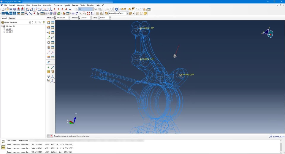

This one is a subset of the previous one (Connection Builder) and it allows to quickly create Couplings and their Reference Points (RP). The user selects a face region (can be one or multiple faces) and the Plug-In creates a RP at the geometric center and adds a coupling in between.
Additionally the user can overrule specific components of the calculated RP coordinates, for example when the RP has to be created at a specific axis. Overall this is much faster than creating those features manually, especially when you need many couplings (e.g. when creating a substructure).
The Plug-In is only for creating these features. Editing or deleting has to be done with the regular options of Abaqus/CAE.
The short video below shows two simple examples. The files are attached.
