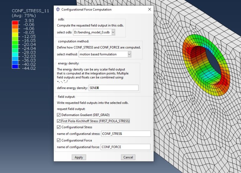

Our Abaqus-Plugin "ConForce" has now been published in SoftwareX https://doi.org/10.1016/j.softx.2024.101718. ConForce computes the configurational (material) forces and writes them into the ODB as a FieldOutput .
Check it out here:
- latest Abaqus plugin: https://github.com/mrettl/conforce/releases
- Documentation: https://conforce.readthedocs.io/en/latest/
