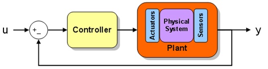

One of the most common aims for the Abaqus-Dymola co-simulation is to build a control system in Dymola that controls a plant simulated in Abaqus, as illustrated in the schematic below.
The controller can be developed either with a Dymola model or a user-subroutine. In many cases it is easier and faster to develop the controller using the Dymola graphical user interface rather than coding a VUAMP subroutine.

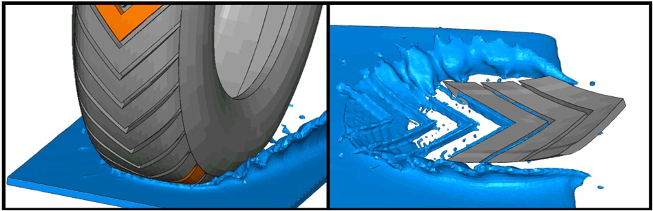

An example of this type of co-simulation is the Automotive Anti-lock Braking System (ABS):
                      Aim: maximize braking torque while maintain a rolling tire
                      Sensors: angular rotation/velocity of the tire spindle.
                      Actuators: breaking torque.
                      Controls: logic in Dymola
                      Physics: Abaqus models include tire, water and road

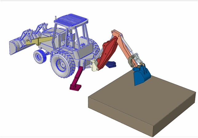

An example is this backhoe:
                       Aim: simulate a Backhoe digging automation
                       Sensors: Arm angles.
                       Actuators: Loads.
                       Physiscs:
                                           - Deformable mechanical components and Soil model in Abaqus
                                           - Hydraulic circuit and Load sensing circuit in Dymola

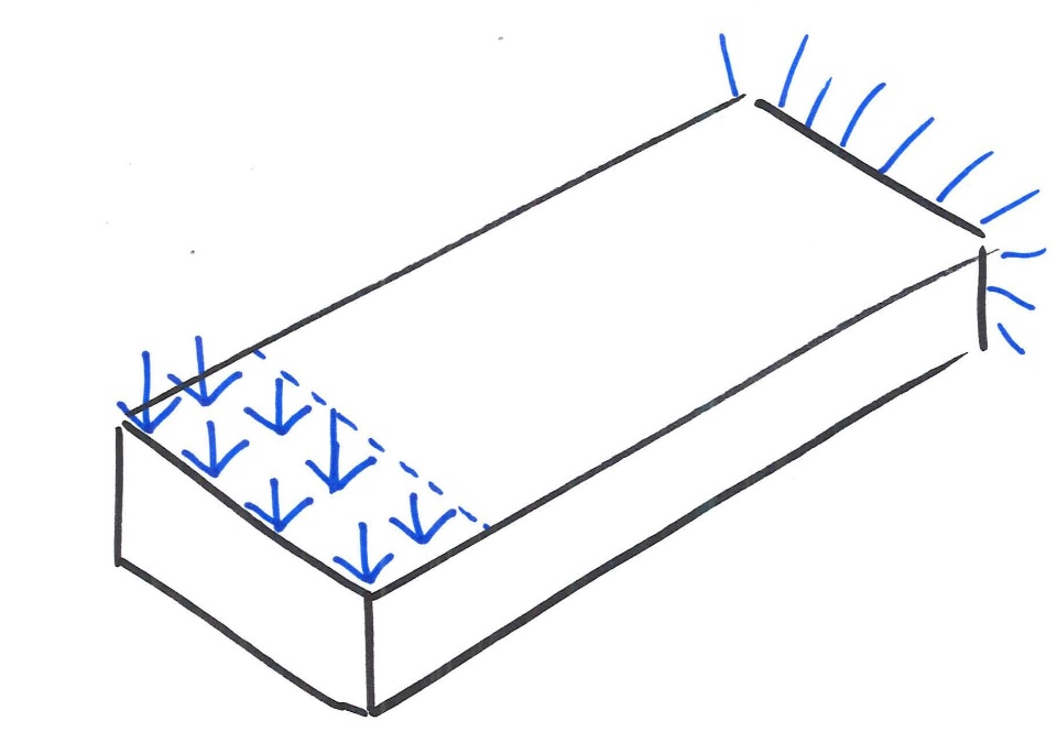

In the video below I will demonstrate how to create an Abaqus-Dymola co-simulation using a very simple example: a 3D solid cantilever with one fixed end and a pressure applied on the other end.
The goal of the simulation is to determine the pressure load required to achieve a target displacement history for the center point of the free end of the beam.

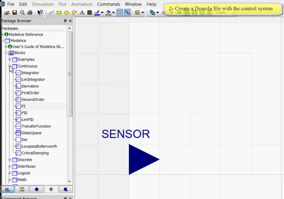

         2- Create a Dymola file with the control system

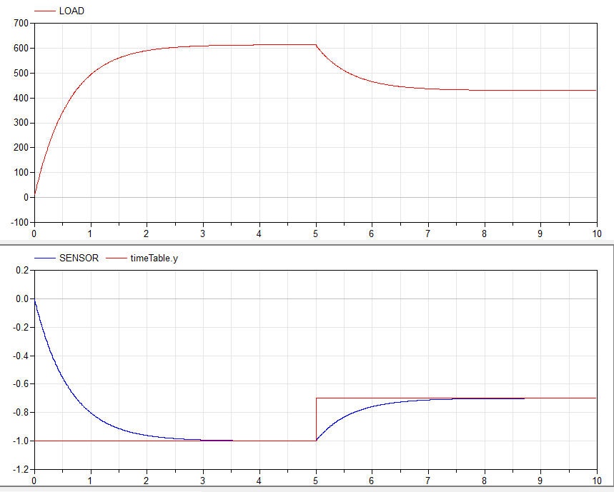

The results of the simulation set up in the video are the followings:
