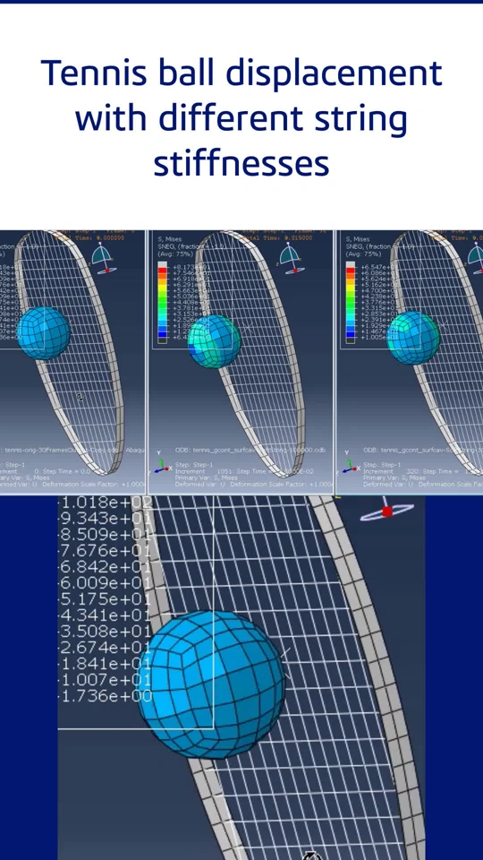

We're playing around with the tennis demo with the long-term aim of creating an off-the-shelf demo that someone could use in a grade school classroom.
We started by importing the Tennis racket and ball example problem from the Abaqus User Assistance Documentation (Abaqus > Example Problems > Dynamic Stress/Displacement Analyses > Dynamic stress analyses > Tennis racket and ball)
So far we have:
  • Adjusted the Young's modulus of the material to find the lowest value that still returns the ball (rather than the ball going straight through the racket)
  • Plotted the displacement of the ball (node chosen on the top of the ball)
  • ▶️ Our Abaqus/CAE file is attached
👉 What would you do next?
We thought we might:
  • Refine the mesh of the racket strings and the ball
  • Modify the ball material properties
  • Modify the string pattern
  • Pretension the strings
