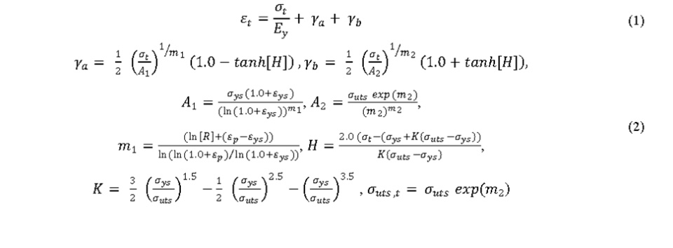

For the purposes of performing an elastic-plastic analysis for a pressurized component, a hardening curve is required.  The FFS document provides the necessary stress-strain relationships that can be utilized to generate the hardening curve.  Equations (1) & (2) list the set of equations that can be utilized in generating the hardening curves.  For incorporating the hardening curve in a finite element analysis using Abaqus, a Stress-strain Curve Calculator plugin for use with Abaqus/CAE was developed.

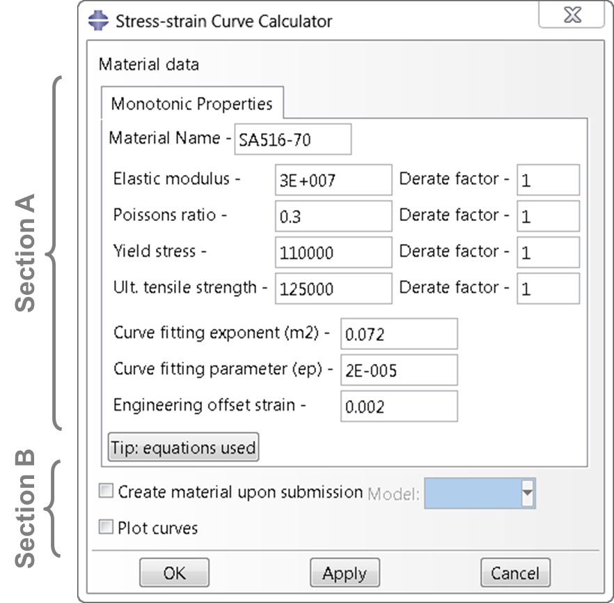

Figure 1.  Stress-Strain Curve Calculator plugin.

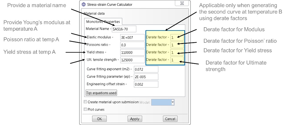

The plugin has two sections A & B as indicated in Figure 1, that require user input.  Section A requires material data input as indicated by the figure below.  In addition, often times, two hardening curves are needed.  The first curve is typically plasticity behavior at room temperature whereas the second curve is at a higher temperature.  Further, the properties are lower at higher temperatures and the derate factors are ratios of properties at higher temperature and those at room temperature.  Please note that the derate factors are assumed to lower than unity.

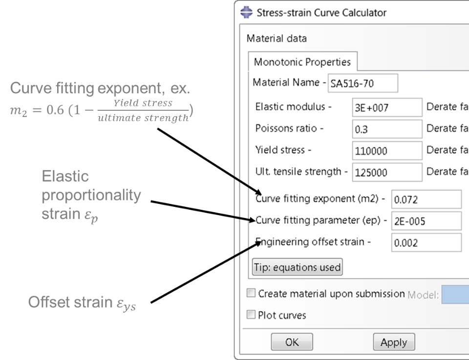

Section A also requires data input for the curve fitting exponent, the elastic proportionality strain, and the offset strain.  The applicable values for these constants can be material specific and the reader is referred to the FFS document for more information.

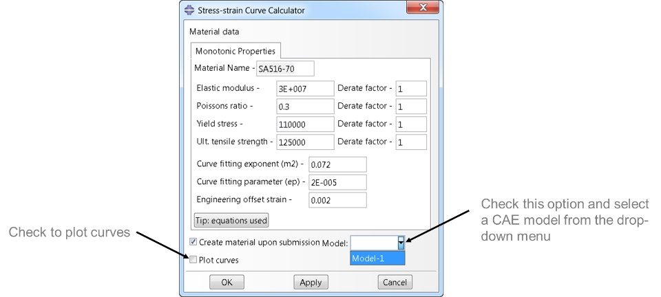

Section B of the plugin provides options to create a material property definition in Abaqus/CAE based on the input and apply it to a specific model.  Further, the curves generated can be plotted for viewing.
