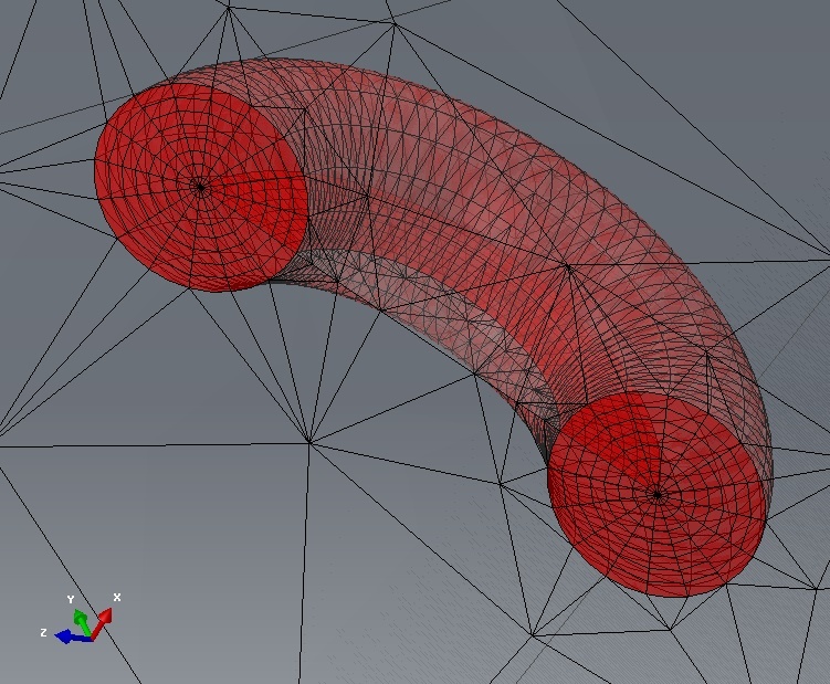

For many years Abaqus/Standard has included the ability to assess quasi-static, stationary crack fracture mechanics problems using contour integrals. While an XFEM-based contour integral method has been added in recent years, the conventional approach involves constructing a specific “focused” mesh configuration at the tip of the presumed crack. This configuration typically includes the following characteristics (some of which are illustrated in Figure 1):
- Two concentric tubular (circular in 2D) regions centered on and surrounding the crack tip;
- The inner tube includes a single set of degenerate 2nd order hex elements
- The outer tube is comprised of a series of concentric rings of 2nd order hex elements;
- Depending on the specifics of the problem the singularity at the crack tip may need to be handled via:
- Biasing of the mid-side nodes of the degenerate crack tip elements to the quarter-point (or some other intermediate location) location toward the crack tip;
- Specific types of crack tip element degeneracy including:
- None
- Collapsed to a single node
- Collapsed to duplicate coincident nodes
Figure 1. Typical "focused mesh" for conventional contour integral method.

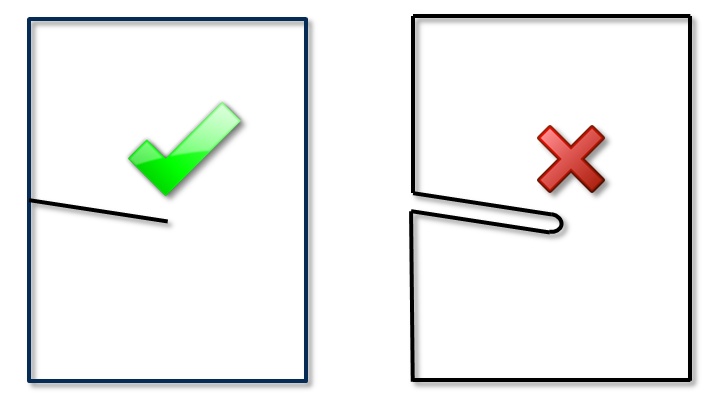

For 2D and simple 3D model geometries, the above tasks add some additional user effort but remain fairly manageable. For more complex 3D geometries the above tasks can become onerous, if not nearly impossible. This plug-in is intended to remove much of the burden in creating these focused mesh configurations for fracture mechanics problems. At present, the plug-in can properly handle cracks modeled as shown in the left-hand image in Figure 2 but not those that look like the right-hand image in that figure.

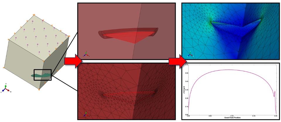

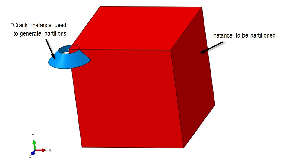

The starting state of an Abaqus/CAE model for use of this plug-in is a model assembly including at least two 3D geometry (i.e., not orphan mesh) part instances. One of these is the instance to be partitioned for focused meshing while the other is simply a 3D shell part geometry introduced to represent the geometry and location of the desired crack face/tip. (The concept is philosophically similar to that used for generating XFEM cracks in Abaqus/CAE.) Figure 3 illustrates a simple, typical case.
Figure 3. Assembly requirements for plug-in use. One instance is to be cut/partitioned, the other is used to define the crack geometry for partition generation.

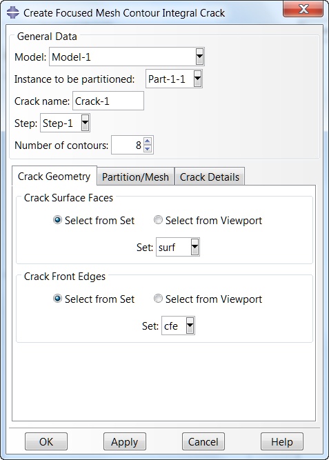

Use of the plug-in is straightforward. To start, invoke the plug-in by selecting the “Build FMCI Crack Model” option from the Plug-ins menu in the Abaqus/CAE environment. This selection instantiates the plug-in dialog box entitled “Create Focused Mesh Contour Integral Crack” and shown in Figure 4.
Figure 4. Focused Mesh Contour Integral plug-in GUI.
For all the details of plug-in usage and limitations select the “Help” button from the plug-in dialog to launch the HTML user’s guide.
