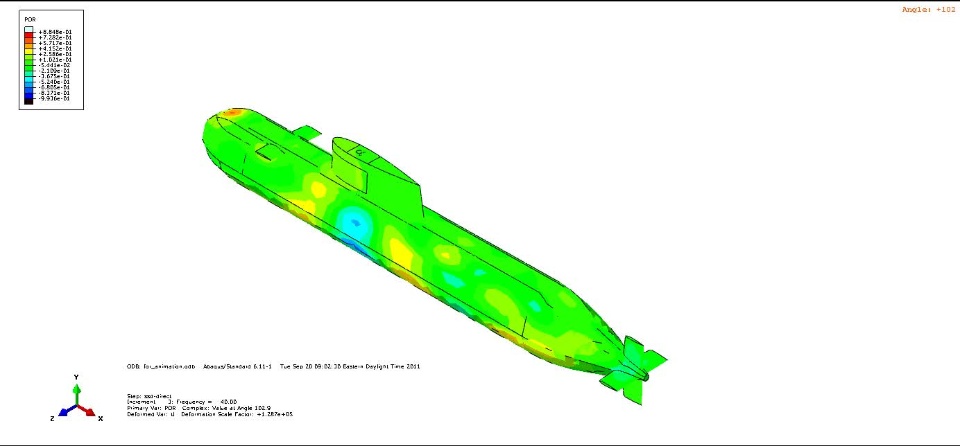

Simulation of underwater acoustics has been a subject of ongoing research for the better-part of 40-years.  Yet while massive increases in computational speed and power have allowed for the solution of larger and larger problems basic solution approaches have actually changed very little.
The acoustic signature and target strength of any submarine is a very closely guarded secret, as acoustic detectability is among the few weaknesses of this weapons system.  Acoustic design is therefore one of the most important aspects to the development of a submarine.
In this study, Drs. Shantharam Dravida, Jonathan Arata and Andrzej Bajer outline the steps used to generate the various models and the platforms used to perform this analyses, as well as presenting the particular results.
