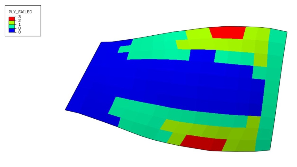

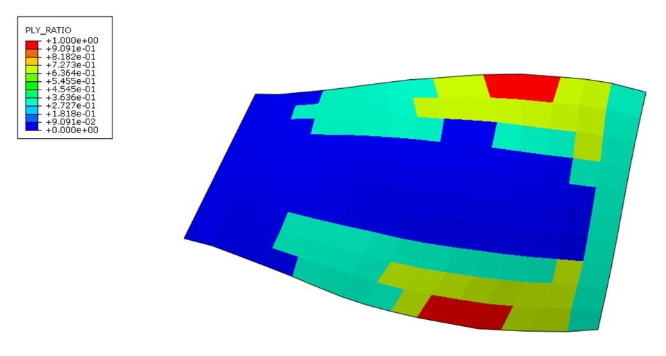

A script has been developed to generate a new field output in the Abaqus/Viewer to show the number of plies failed for each element and the ratio of plies failed, where 0 indicates “no ply has failed” and 1 indicates “all plies have failed”

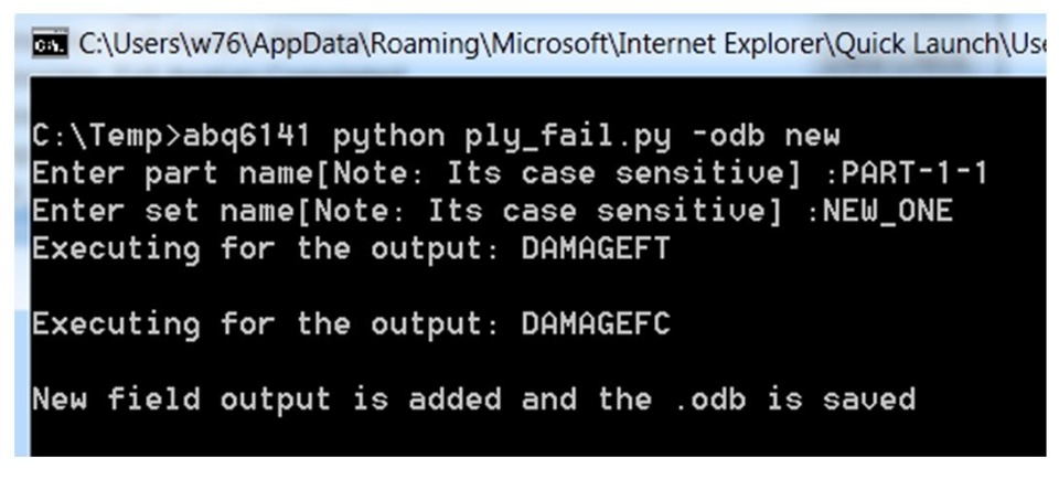

The script and the files to be read are to be placed in the local/working directory. The script should be executed from the command prompt as shown below:
abaqus python
For example, the command:
abaqus python ply_fail.py -odb new
When the script is run, it prompts the user to input the part name and the element set name of interest.
The output can by visualized for plotting the output variable ply_failed and ply_ratio, which indicates the number of plies failed and the ratio of plies failed respectively. Since it’s an elemental quantity, please use QUILT plot to see the failure in each element.

Figure: Field output for the number of plies failed
Figure: Field output for the ratio of plies failed
