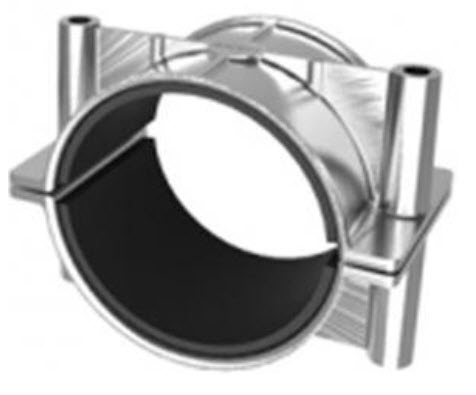

These two techniques are well known, however, the very general description of connector elements means they can be used for other purposes! The attached document, written by Stephen King from the UK CSE, shows how they can be used to model the system which connectors high voltage power cables to the supports.
It would be computational inefficient to model the connections using contact and traditional elements. Instead they are abstracted to a two noded connector element which captures the physics of the connection accurately.
